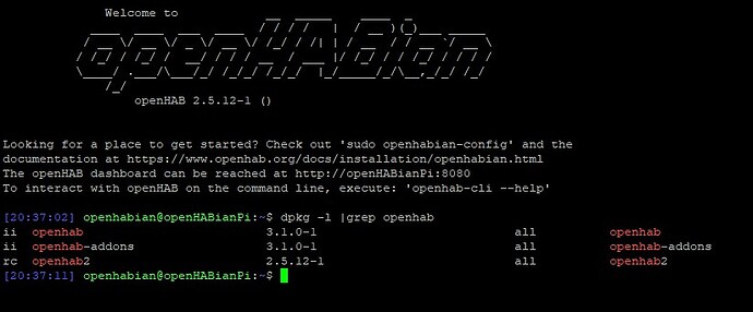

OpenHAB 3.1 successful, but openhabian (Putty) always starts in 2.5.12-1
I’ve sucessfully updated to openhab 3.1 but whenever I fire up openhabian in putty the logo screen shows I’m still running 2.5.12-1

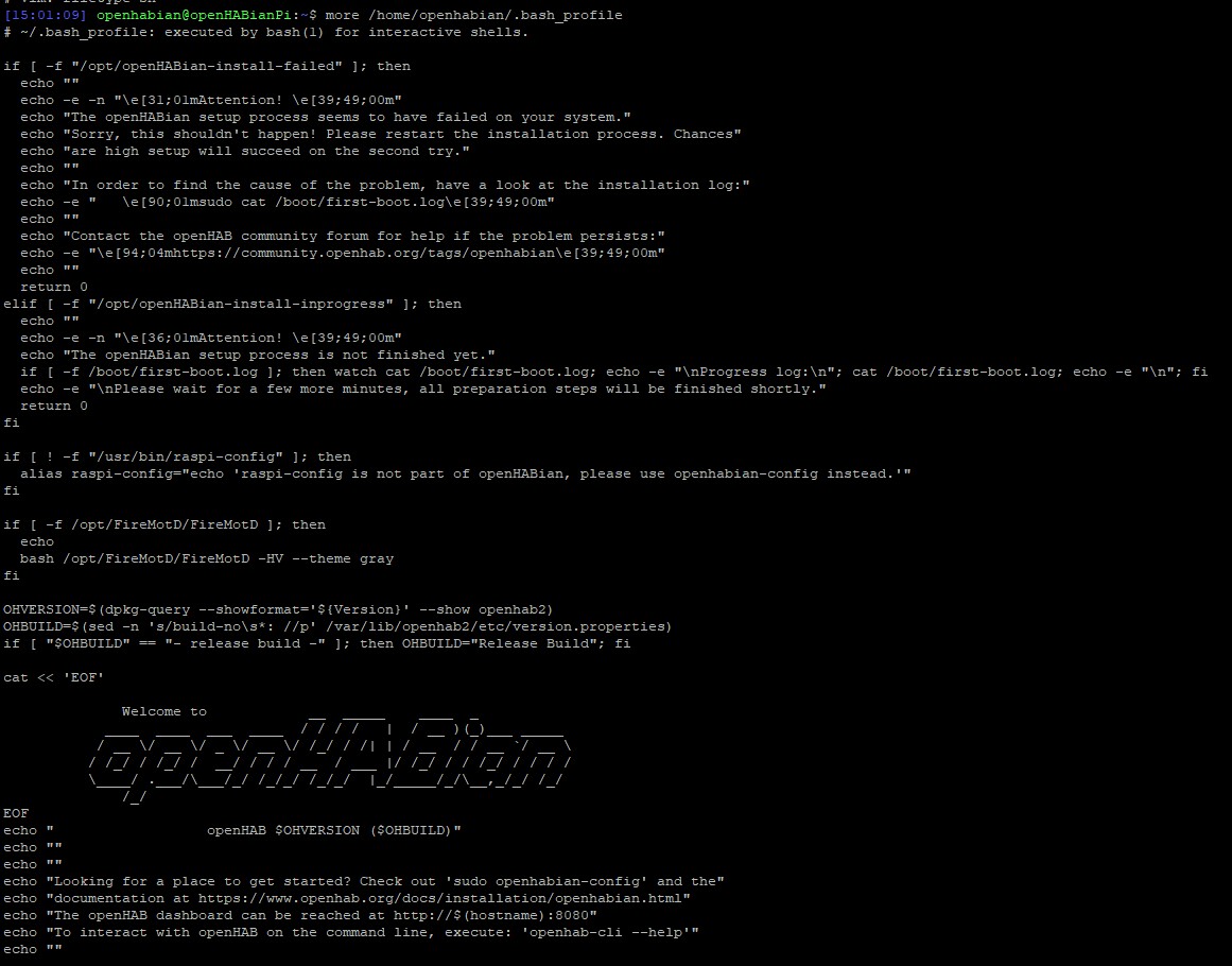

These are my results
Sorry to say but screenshots are not that easy to read like text that is copied into code fences.
This is an older version of the .bash_profile that was created by openhabian-config.
Either you need to get a newer one or remove the 2 in openhab2 string in the row that contains the string “dpkg-query --showformat=‘${Version}’ --show openhab2”.

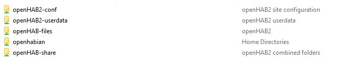

Is it normal that the folder structure still shows openHAB2-conf? and not just openHAB-conf
That also should be migrated.
Which menu entry did you use to migrate from openhab2 to openhab ?
03 or 42 ?
As far as I understand 03 upgrades openhab while 42 upgrades openhabian which means also the samba configuration.
