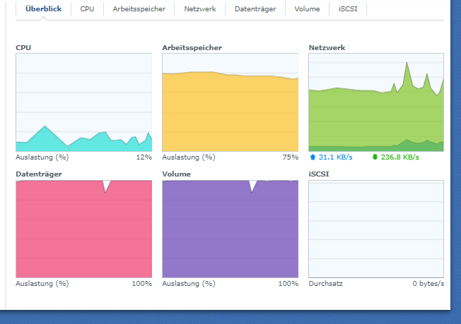

As I failed to migrate my OH2.5.11 (Openhabian) to OH 3.0 stable (docker), I decided to take this as an opportunity to create everything from scratch. I faced all the time the issue, that the disk utilization got a huge peak up to 100 % - I thought, it has some issues within my rules, items, etc. and starting from scratch is a chance to correct mistakes from the past.
I installed OH3.0 stable at Docker on a Synology with the following bindings:

Not more - no rules, no transformation - nothing, pure standard. And again, I got high disk utilization (100 % for many minutes) which fully blocks all activities at the disk station.
If I shut down the OpenHab container, everything went back to normal.

I think I overkilled the diskstation itself with the services (like Dockers container, Surveillance Station, Synology Drive, etc) running on it.
In the overview of Docker it showed, that Docker used only 1,1 GB of 2 GB, which sounded not that bad to me, but in reality it started to swap data to the hdd.
After adding physically additional 4 GB RAM, it is back to normal and I could continue my journey to OH3.
