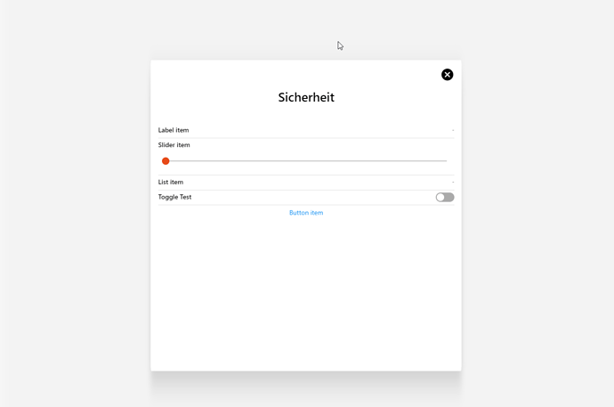

If clicking on the submenu (3 dots) of the cell, I would like to see the group popup, showing the members of my security group. This is not working, always get a blank page…
I think that this isn’t possible out-of-the-box atm (at least not as a dynamic created list from group items) as there is only a ‘group-popup’ vue-component available currently.
So, what IS possible and works with your first example is a cell inside the cell which triggers the popup in which the item-list gets generated (based on the group items). So you open a poup from inside a popup, which is obviously not beautful.

@hmerk I tried to come around the native oh-cell and created a version with f7-components. It opens the keypad-widget with a click on the cell-element and the gSecurity-group as a popup with a click on the dots. But it might need some polishing on the font-sizes etc.
Maybe it fits your needs a bit more - and also creates the group-popup dynamically (so no more extra work creating a list-element inside the expanded-cell)

Thanks again Rainer, your second version is working as expected, but I will stick to the first one, which gave me the ability to experiment with the badges a bit more.
Here is the result of my “group popup”
