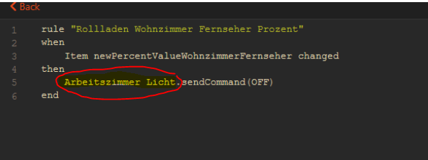

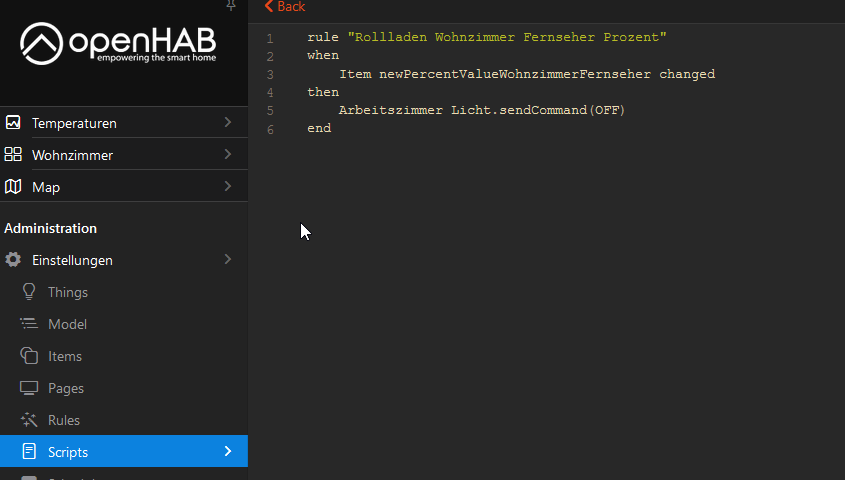

Hi I created a small scrippt for testing because other scripts are also not running.
if i want to test it i get the following answer in the console:
can anybody explaneto me what I’m doing wrong ?

You have to define the trigger in the ui when creating the rule. The script is only the part between then and end.
what do ypu mean with trigger ? a rule ?
Scripts are only meant to run without a trigger. in your case, just the part between when and end.
What you need is a rule.
when part) and then you give as action a script. There you can put just the part between when and end in. Then it should work.
OK thanks, understood.
So this means Openhab 3, i can not use my old rules ?
No, you can use your old rules. Either by text files (as in OH2) or with the MainUI. The only difference is that the when part is set by the MainUI instead of coded in your rule.
So in the MainUI you give as trigger newPerecentValueWhonzimmerFernseher changed and in the action part, you select script/DSL and past Arbeitszimmer Licht.sendCommand(OFF) (the item is not correct, as @Silver8000 said!)
or you select as action Item action and pick in the UI your item and select the action send command to and fill in OFF
