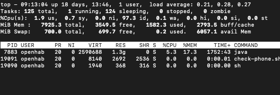

I am running on a PI 4+ with 8GB and still had the problem…I upgraded a week ago, and did not do any more upgrades, just let the system run, and do normal setup work in rules/widgets/items, so system was not in “pause mode”.
And it run for a week now w/o any problems. Current Status:
