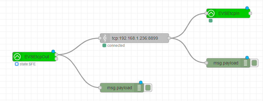

Thanks for sharing. I’ve checked my configuration against yours and it looks the same but it’s not working for me.
The inbound is fine; if I trigger a command from a PuTTY connection, NodeRed and OpenHAB are getting the response but for the life of me, I can’t get a change in the outbound item to send the string to the device, even though the debug message shows what the TCP node should have received.
I noticed that using your method, NodeRed creates two connections to the device, one for the Tx and one for the Rx. as I’ve limited my device to two connections (for OpenHAB and PuTTY), it was a problem so I’m using the 2-way TCP node. I also tried separating the inbound and outbound items but still no luck.
Thanks again for the NodeRed solution; I’m guessing it’s something about my device.
