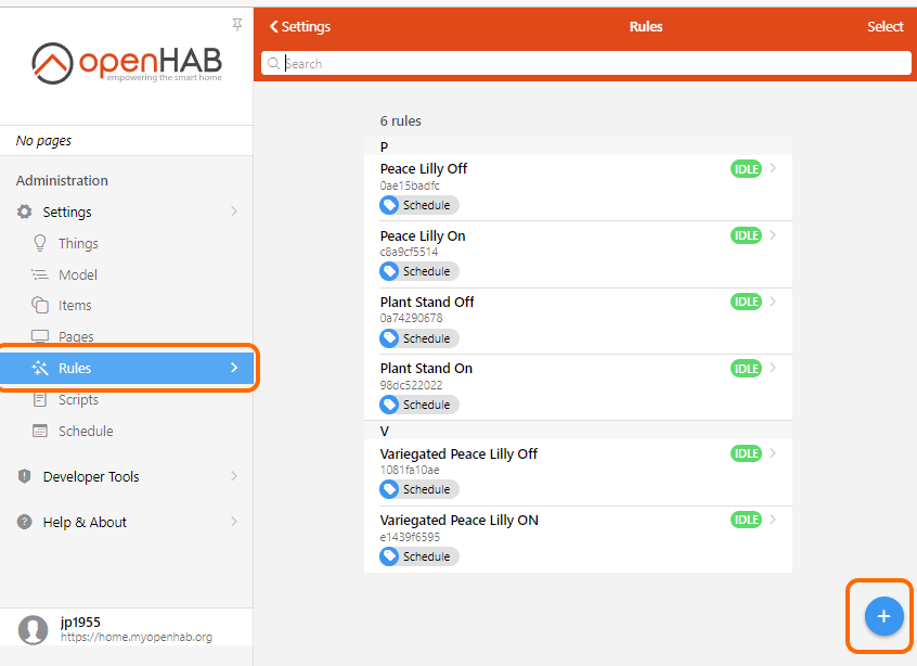

Is there an issue with rules? In particular, I am using the “built in” rules from the menu on the left of OH and have some rules that use timers (clock) to turn lights on/off at certain times. Is that functionality broken?
What “rules from the menu on the left” ?
In General, rules are working fine, I also uses scheduled rules to open my blinds at a certainn time in the morning and close them in the evening.
I am just about to move my productive environment to 4.0 …
The rules created from here. Simply control an item at a certain time.
OK, those are normal UI created rules, which I als use for my blinds and many other things.
Yes, they are working!

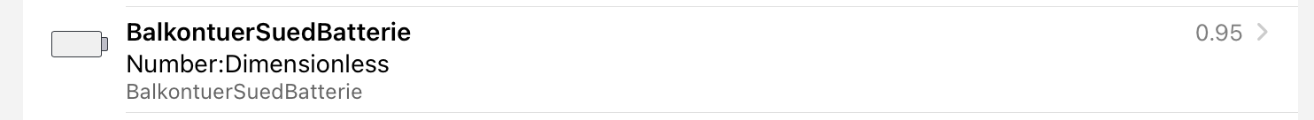

After updating from 4.0.0 to 4.0.0.M3 the batterie level scaling of all my shelly things are quite curious (all other works as before).
The value in the item list is decimal (here 0.95), the value in the item itself is percentage and the value in the graph is decimal again. Before update the value was not decimal but a number with percentage value. I don’t use state description pattern or something like that.
How can I get the “old” value back?
When I use the battery level now with the battery icon, it doesn’t work anymore (graphical display from green to red) and also the graph widget uses now the decimal value (0-1 instead of 0-100).
You need to apply the unit metadata to your percent Items as was discussed in the M3 release notes.
