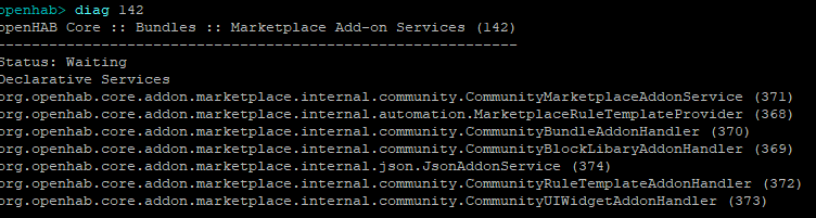

Briefly tested M1 but had to return to 3.4.2. Here is the log, I hope it helps

2023-03-12 09:32:12.958 [ERROR] [ity.CommunityMarketplaceAddonService] - bundle org.openhab.core.addon.marketplace:4.0.0.M1 (142)[org.openhab.core.addon.marketplace.internal.community.CommunityMarketplaceAddonService(51)] : Error during instantiation of the implementation object
java.lang.reflect.InvocationTargetException: null

	at com.google.gson.internal.bind.CollectionTypeAdapterFactory$Adapter.read(CollectionTypeAdapterFactory.java:61) ~[?:?]
	at com.google.gson.internal.bind.ReflectiveTypeAdapterFactory$1.read(ReflectiveTypeAdapterFactory.java:161) ~[?:?]
	at com.google.gson.internal.bind.ReflectiveTypeAdapterFactory$Adapter.read(ReflectiveTypeAdapterFactory.java:266) ~[?:?]
	at com.google.gson.Gson.fromJson(Gson.java:1058) ~[?:?]
	at com.google.gson.Gson.fromJson(Gson.java:1016) ~[?:?]
	at com.google.gson.Gson.fromJson(Gson.java:959) ~[?:?]
	at com.google.gson.Gson.fromJson(Gson.java:927) ~[?:?]
	at org.openhab.core.addon.marketplace.AbstractRemoteAddonService.lambda$2(AbstractRemoteAddonService.java:93) ~[?:?]
	at java.util.stream.ReferencePipeline$3$1.accept(ReferencePipeline.java:197) ~[?:?]
	at java.util.concurrent.ConcurrentHashMap$KeySpliterator.forEachRemaining(ConcurrentHashMap.java:3573) ~[?:?]
	at java.util.stream.AbstractPipeline.copyInto(AbstractPipeline.java:509) ~[?:?]
	at java.util.stream.AbstractPipeline.wrapAndCopyInto(AbstractPipeline.java:499) ~[?:?]
	at java.util.stream.ForEachOps$ForEachOp.evaluateSequential(ForEachOps.java:150) ~[?:?]
	at java.util.stream.ForEachOps$ForEachOp$OfRef.evaluateSequential(ForEachOps.java:173) ~[?:?]
	at java.util.stream.AbstractPipeline.evaluate(AbstractPipeline.java:234) ~[?:?]
	at java.util.stream.ReferencePipeline.forEach(ReferencePipeline.java:596) ~[?:?]
	at org.openhab.core.addon.marketplace.AbstractRemoteAddonService.refreshSource(AbstractRemoteAddonService.java:94) ~[?:?]
	at org.openhab.core.addon.marketplace.internal.community.CommunityMarketplaceAddonService.modified(CommunityMarketplaceAddonService.java:131) ~[?:?]
	at org.openhab.core.addon.marketplace.internal.community.CommunityMarketplaceAddonService.<init>(CommunityMarketplaceAddonService.java:120) ~[?:?]
	... 65 more
2023-03-12 09:32:13.122 [ERROR] [place.internal.json.JsonAddonService] - bundle org.openhab.core.addon.marketplace:4.0.0.M1 (142)[org.openhab.core.addon.marketplace.internal.json.JsonAddonService(54)] : Error during instantiation of the implementation object
	at jdk.internal.reflect.NativeConstructorAccessorImpl.newInstance0(Native Method) ~[?:?]
	at jdk.internal.reflect.NativeConstructorAccessorImpl.newInstance(NativeConstructorAccessorImpl.java:77) ~[?:?]
	at jdk.internal.reflect.DelegatingConstructorAccessorImpl.newInstance(DelegatingConstructorAccessorImpl.java:45) ~[?:?]
	at java.lang.reflect.Constructor.newInstanceWithCaller(Constructor.java:499) ~[?:?]
	at java.lang.reflect.Constructor.newInstance(Constructor.java:480) ~[?:?]
	at org.apache.felix.scr.impl.inject.internal.ComponentConstructorImpl.newInstance(ComponentConstructorImpl.java:326) ~[?:?]
	at org.apache.felix.scr.impl.manager.SingleComponentManager.createImplementationObject(SingleComponentManager.java:286) ~[?:?]
	at org.apache.felix.scr.impl.manager.SingleComponentManager.createComponent(SingleComponentManager.java:115) ~[?:?]
	at org.apache.felix.scr.impl.manager.SingleComponentManager.getService(SingleComponentManager.java:1002) ~[?:?]
	at org.apache.felix.scr.impl.manager.SingleComponentManager.getServiceInternal(SingleComponentManager.java:975) ~[?:?]
	at org.apache.felix.scr.impl.manager.SingleComponentManager.getService(SingleComponentManager.java:920) ~[?:?]
	at org.eclipse.osgi.internal.serviceregistry.ServiceFactoryUse$1.run(ServiceFactoryUse.java:220) ~[org.eclipse.osgi-3.18.0.jar:?]
	at java.security.AccessController.doPrivileged(AccessController.java:318) ~[?:?]
	at org.eclipse.osgi.internal.serviceregistry.ServiceFactoryUse.factoryGetService(ServiceFactoryUse.java:217) ~[org.eclipse.osgi-3.18.0.jar:?]
	at org.eclipse.osgi.internal.serviceregistry.ServiceFactoryUse.getService(ServiceFactoryUse.java:118) ~[org.eclipse.osgi-3.18.0.jar:?]
	at org.eclipse.osgi.internal.serviceregistry.ServiceConsumer$2.getService(ServiceConsumer.java:48) ~[org.eclipse.osgi-3.18.0.jar:?]
	at org.eclipse.osgi.internal.serviceregistry.ServiceRegistrationImpl.getService(ServiceRegistrationImpl.java:547) ~[org.eclipse.osgi-3.18.0.jar:?]
	at org.eclipse.osgi.internal.serviceregistry.ServiceRegistry.getService(ServiceRegistry.java:534) ~[org.eclipse.osgi-3.18.0.jar:?]
	at org.eclipse.osgi.internal.framework.BundleContextImpl.getService(BundleContextImpl.java:660) ~[org.eclipse.osgi-3.18.0.jar:?]
	at org.apache.felix.scr.impl.manager.SingleRefPair.getServiceObject(SingleRefPair.java:88) ~[?:?]
	at org.apache.felix.scr.impl.inject.methods.BindMethod.getServiceObject(BindMethod.java:675) ~[?:?]
	at org.apache.felix.scr.impl.manager.DependencyManager.getServiceObject(DependencyManager.java:2612) ~[?:?]
	at org.apache.felix.scr.impl.manager.DependencyManager.doInvokeBindMethod(DependencyManager.java:2078) ~[?:?]
	at org.apache.felix.scr.impl.manager.DependencyManager.invokeBindMethod(DependencyManager.java:2061) ~[?:?]
	at org.apache.felix.scr.impl.manager.SingleComponentManager.invokeBindMethod(SingleComponentManager.java:443) ~[?:?]
	at org.apache.felix.scr.impl.manager.DependencyManager$MultipleDynamicCustomizer.addedService(DependencyManager.java:336) ~[?:?]
	at org.apache.felix.scr.impl.manager.DependencyManager$MultipleDynamicCustomizer.addedService(DependencyManager.java:304) ~[?:?]
	at org.apache.felix.scr.impl.manager.ServiceTracker$Tracked.customizerAdded(ServiceTracker.java:1232) ~[?:?]
	at org.apache.felix.scr.impl.manager.ServiceTracker$Tracked.customizerAdded(ServiceTracker.java:1152) ~[?:?]
	at org.apache.felix.scr.impl.manager.ServiceTracker$AbstractTracked.trackAdding(ServiceTracker.java:959) ~[?:?]
	at org.apache.felix.scr.impl.manager.ServiceTracker$AbstractTracked.track(ServiceTracker.java:895) ~[?:?]
	at org.apache.felix.scr.impl.manager.ServiceTracker$Tracked.serviceChanged(ServiceTracker.java:1184) ~[?:?]
	at org.apache.felix.scr.impl.BundleComponentActivator$ListenerInfo.serviceChanged(BundleComponentActivator.java:116) ~[?:?]
	at org.eclipse.osgi.internal.serviceregistry.FilteredServiceListener.serviceChanged(FilteredServiceListener.java:123) ~[org.eclipse.osgi-3.18.0.jar:?]
	at org.eclipse.osgi.internal.framework.BundleContextImpl.dispatchEvent(BundleContextImpl.java:961) ~[org.eclipse.osgi-3.18.0.jar:?]
	at org.eclipse.osgi.framework.eventmgr.EventManager.dispatchEvent(EventManager.java:234) ~[org.eclipse.osgi-3.18.0.jar:?]
	at org.eclipse.osgi.framework.eventmgr.ListenerQueue.dispatchEventSynchronous(ListenerQueue.java:151) ~[org.eclipse.osgi-3.18.0.jar:?]
	at org.eclipse.osgi.internal.serviceregistry.ServiceRegistry.publishServiceEventPrivileged(ServiceRegistry.java:937) ~[org.eclipse.osgi-3.18.0.jar:?]
	at org.eclipse.osgi.internal.serviceregistry.ServiceRegistry.publishServiceEvent(ServiceRegistry.java:874) ~[org.eclipse.osgi-3.18.0.jar:?]
	at org.eclipse.osgi.internal.serviceregistry.ServiceRegistrationImpl.register(ServiceRegistrationImpl.java:141) ~[org.eclipse.osgi-3.18.0.jar:?]
	at org.eclipse.osgi.internal.serviceregistry.ServiceRegistry.registerService(ServiceRegistry.java:262) ~[org.eclipse.osgi-3.18.0.jar:?]
	at org.eclipse.osgi.internal.framework.BundleContextImpl.registerService(BundleContextImpl.java:500) ~[org.eclipse.osgi-3.18.0.jar:?]
	at org.apache.felix.scr.impl.manager.AbstractComponentManager$3.register(AbstractComponentManager.java:929) ~[?:?]
	at org.apache.felix.scr.impl.manager.AbstractComponentManager$3.register(AbstractComponentManager.java:915) ~[?:?]
	at org.apache.felix.scr.impl.manager.RegistrationManager.changeRegistration(RegistrationManager.java:133) ~[?:?]
	at org.apache.felix.scr.impl.manager.AbstractComponentManager.registerService(AbstractComponentManager.java:984) ~[?:?]
	at org.apache.felix.scr.impl.manager.AbstractComponentManager.activateInternal(AbstractComponentManager.java:752) ~[?:?]
	at org.apache.felix.scr.impl.manager.DependencyManager$SingleStaticCustomizer.addedService(DependencyManager.java:1274) ~[?:?]
	at org.apache.felix.scr.impl.manager.DependencyManager$SingleStaticCustomizer.addedService(DependencyManager.java:1225) ~[?:?]
	at org.apache.felix.scr.impl.manager.AbstractComponentManager.enableInternal(AbstractComponentManager.java:674) ~[?:?]
	at org.apache.felix.scr.impl.manager.AbstractComponentManager.enable(AbstractComponentManager.java:437) ~[?:?]
	at org.apache.felix.scr.impl.manager.ConfigurableComponentHolder.enableComponents(ConfigurableComponentHolder.java:671) ~[?:?]
	at org.apache.felix.scr.impl.BundleComponentActivator.initialEnable(BundleComponentActivator.java:310) ~[?:?]
	at org.apache.felix.scr.impl.Activator.loadComponents(Activator.java:593) ~[?:?]
	at org.apache.felix.scr.impl.Activator.access$200(Activator.java:74) ~[?:?]
	at org.apache.felix.scr.impl.Activator$ScrExtension.start(Activator.java:460) ~[?:?]
	at org.apache.felix.scr.impl.AbstractExtender.createExtension(AbstractExtender.java:196) ~[?:?]
	at org.apache.felix.scr.impl.AbstractExtender.modifiedBundle(AbstractExtender.java:169) ~[?:?]
	at org.apache.felix.scr.impl.AbstractExtender.modifiedBundle(AbstractExtender.java:49) ~[?:?]
	at org.osgi.util.tracker.BundleTracker$Tracked.customizerModified(BundleTracker.java:488) ~[osgi.core-8.0.0.jar:?]
	at org.osgi.util.tracker.BundleTracker$Tracked.customizerModified(BundleTracker.java:420) ~[osgi.core-8.0.0.jar:?]
	at org.osgi.util.tracker.AbstractTracked.track(AbstractTracked.java:232) ~[osgi.core-8.0.0.jar:?]
	at org.osgi.util.tracker.BundleTracker$Tracked.bundleChanged(BundleTracker.java:450) ~[osgi.core-8.0.0.jar:?]
	at org.eclipse.osgi.internal.framework.BundleContextImpl.dispatchEvent(BundleContextImpl.java:949) ~[org.eclipse.osgi-3.18.0.jar:?]
	at org.eclipse.osgi.internal.framework.EquinoxEventPublisher.publishBundleEventPrivileged(EquinoxEventPublisher.java:229) ~[org.eclipse.osgi-3.18.0.jar:?]
	at org.eclipse.osgi.internal.framework.EquinoxEventPublisher.publishBundleEvent(EquinoxEventPublisher.java:138) ~[org.eclipse.osgi-3.18.0.jar:?]
	at org.eclipse.osgi.internal.framework.EquinoxEventPublisher.publishBundleEvent(EquinoxEventPublisher.java:130) ~[org.eclipse.osgi-3.18.0.jar:?]
	at org.eclipse.osgi.internal.framework.EquinoxContainerAdaptor.publishModuleEvent(EquinoxContainerAdaptor.java:217) ~[org.eclipse.osgi-3.18.0.jar:?]
	at org.eclipse.osgi.container.Module.publishEvent(Module.java:499) ~[org.eclipse.osgi-3.18.0.jar:?]
	at org.eclipse.osgi.container.Module.start(Module.java:486) ~[org.eclipse.osgi-3.18.0.jar:?]
	at org.eclipse.osgi.container.ModuleContainer$ContainerStartLevel$2.run(ModuleContainer.java:1847) ~[org.eclipse.osgi-3.18.0.jar:?]
	at org.eclipse.osgi.internal.framework.EquinoxContainerAdaptor$1$1.execute(EquinoxContainerAdaptor.java:136) ~[org.eclipse.osgi-3.18.0.jar:?]
	at org.eclipse.osgi.container.ModuleContainer$ContainerStartLevel.incStartLevel(ModuleContainer.java:1840) ~[org.eclipse.osgi-3.18.0.jar:?]
	at org.eclipse.osgi.container.ModuleContainer$ContainerStartLevel.incStartLevel(ModuleContainer.java:1783) ~[org.eclipse.osgi-3.18.0.jar:?]
	at org.eclipse.osgi.container.ModuleContainer$ContainerStartLevel.doContainerStartLevel(ModuleContainer.java:1745) ~[org.eclipse.osgi-3.18.0.jar:?]
	at org.eclipse.osgi.container.ModuleContainer$ContainerStartLevel.dispatchEvent(ModuleContainer.java:1667) ~[org.eclipse.osgi-3.18.0.jar:?]
	at org.eclipse.osgi.container.ModuleContainer$ContainerStartLevel.dispatchEvent(ModuleContainer.java:1) ~[org.eclipse.osgi-3.18.0.jar:?]
	at org.eclipse.osgi.framework.eventmgr.EventManager$EventThread.run(EventManager.java:345) ~[org.eclipse.osgi-3.18.0.jar:?]
Caused by: com.google.gson.JsonSyntaxException: java.lang.IllegalStateException: Expected BEGIN_ARRAY but was STRING at line 1 column 542 path $.countries
	at com.google.gson.internal.bind.ReflectiveTypeAdapterFactory$Adapter.read(ReflectiveTypeAdapterFactory.java:270) ~[?:?]
	at org.openhab.core.addon.marketplace.internal.json.JsonAddonService.modified(JsonAddonService.java:93) ~[?:?]
	at org.openhab.core.addon.marketplace.internal.json.JsonAddonService.<init>(JsonAddonService.java:83) ~[?:?]
	... 101 more
Caused by: java.lang.IllegalStateException: Expected BEGIN_ARRAY but was STRING at line 1 column 542 path $.countries
	at com.google.gson.stream.JsonReader.beginArray(JsonReader.java:360) ~[?:?]
	at com.google.gson.internal.bind.CollectionTypeAdapterFactory$Adapter.read(CollectionTypeAdapterFactory.java:80) ~[?:?]

I may have similar problem as @moody_blue . Something is amiss with the MarketPlace addon. My log is below.(sorry for the length this error really prints it out). Other information: have two systems running on M1, pi3 which loaded the marketplace okay, but I had no addons used in it and an rpi4 that was using the sony binding. Interestingly the sony addon still works, so I did not revert back to OH3. The bundle is “waiting”
2023-03-11 10:46:13.844 [ERROR] [ity.CommunityMarketplaceAddonService] - bundle org.openhab.core.addon.marketplace:4.0.0.M1 (142)[org.openhab.core.addon.marketplace.internal.community.CommunityMarketplaceAddonService(45)] : Error during instantiation of the implementation object

Caused by: com.google.gson.JsonSyntaxException: java.lang.IllegalStateException: Expected BEGIN_ARRAY but was STRING at line 1 column 27891 path $.countries
	... 101 more
Caused by: java.lang.IllegalStateException: Expected BEGIN_ARRAY but was STRING at line 1 column 27891 path $.countries
	... 101 more
2023-03-11 10:46:13.909 [WARN ] [t.core.internal.addons.AddonResource] - bundle org.openhab.core.io.rest.core:4.0.0.M1 (168)[org.openhab.core.io.rest.core.internal.addons.AddonResource(159)] : Could not get service from ref {org.openhab.core.addon.AddonService}={service.id=353, service.bundleid=142, service.scope=bundle, osgi.ds.satisfying.condition.target=(osgi.condition.id=true), service.config.label=Community Marketplace, component.name=org.openhab.core.addon.marketplace.internal.community.CommunityMarketplaceAddonService, component.id=45, service.config.factory=false, service.config.category=system, service.pid=org.openhab.marketplace, service.config.description.uri=system:marketplace}
2023-03-11 10:46:13.911 [WARN ] [t.core.internal.addons.AddonResource] - bundle org.openhab.core.io.rest.core:4.0.0.M1 (168)[org.openhab.core.io.rest.core.internal.addons.AddonResource(159)] : DependencyManager : invokeBindMethod : Service not available from service registry for ServiceReference {org.openhab.core.addon.AddonService}={service.id=353, service.bundleid=142, service.scope=bundle, osgi.ds.satisfying.condition.target=(osgi.condition.id=true), service.config.label=Community Marketplace, component.name=org.openhab.core.addon.marketplace.internal.community.CommunityMarketplaceAddonService, component.id=45, service.config.factory=false, service.config.category=system, service.pid=org.openhab.marketplace, service.config.description.uri=system:marketplace} for reference AddonService
I have experienced the same problem when I had a marketplace binding installed which was built for openHAB 3.4.x.
openHAB 4 upgraded both Java and Karaf, which breaks compatibility between addons compiled for 3.4.x and openHAB 4.
Therefore, you need to uninstall all marketplace addons not compatible with 4 to get rid of this message, however it might be possible to touch the JSONDB for that.
@core-maintainers Please correct my if I’m saying something wrong.
If I downgrade, remove the addon, then upgrade and add the sony back would it likely work (or is the sony addon being distributed with M1 just not going to work? I would have thought the sony 3.4 version would have been cleaned out during the upgrade process?
Which Sony addon? Marketplace or not?
