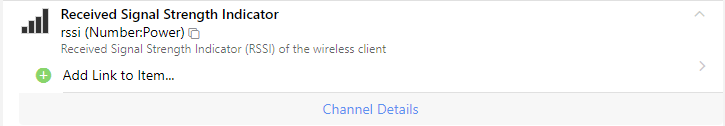

With snapshot build 3358, am I the only one not being able to see “Channel Details” in Main UI?
Click - then nothing:

I think that #1683 caused these details to be removed from the channel edit page (channel-edit.vue).
My PR refactored the detail sheet into its own component, which works fine if I test it.
I think something must be wrong with the loading, the channel-general-settings component doesn’t show its content if ready is not true.
@laursen Does the browser console or the network tab show something?
working perfect ! Thanks for fast solution :heart_eyes:
I will check this when I’m home from work, but probably it will be too late for M1. For reference:
Does this also affect channel configuration? In that case it would be a blocking for M1.
