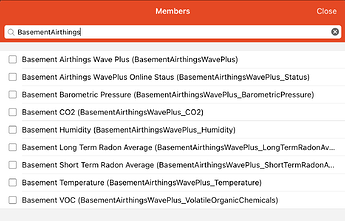

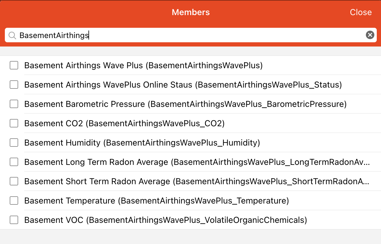

Create the group and add them from the Group’s page. Should be able to add all the items in one go. The pop-up supports search so if they are named similarly you can get them all at once.
I created a Group and added all those Airthings Items to it in about 15 seconds.
Just for clarity:
  1. Create the Group. In this case you probably want to create a new Equipment so you can even do this from the Model page.
  2. Navigate to the newly created Group’s page.
  3. You should see “Direct Group Members”. Click “Change”, put in a search that will matching all your Groupless Items and click the checkbox to select them and add them to the Group.
This should not be too painful and if this is missing from the docs it needs to be added. It’s a huge time saver if you are going to each individual Item and adding them to the Group one-by-one.

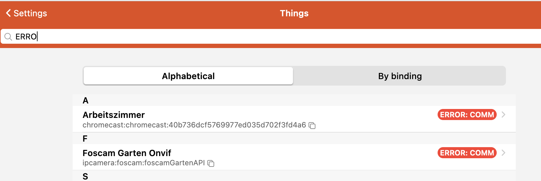

Thanks to all the developers for making openhab the powerhouse it is. My wish is for the ability to filter the thing list in the UI based on status. That way I could quickly find malfunctioning things.

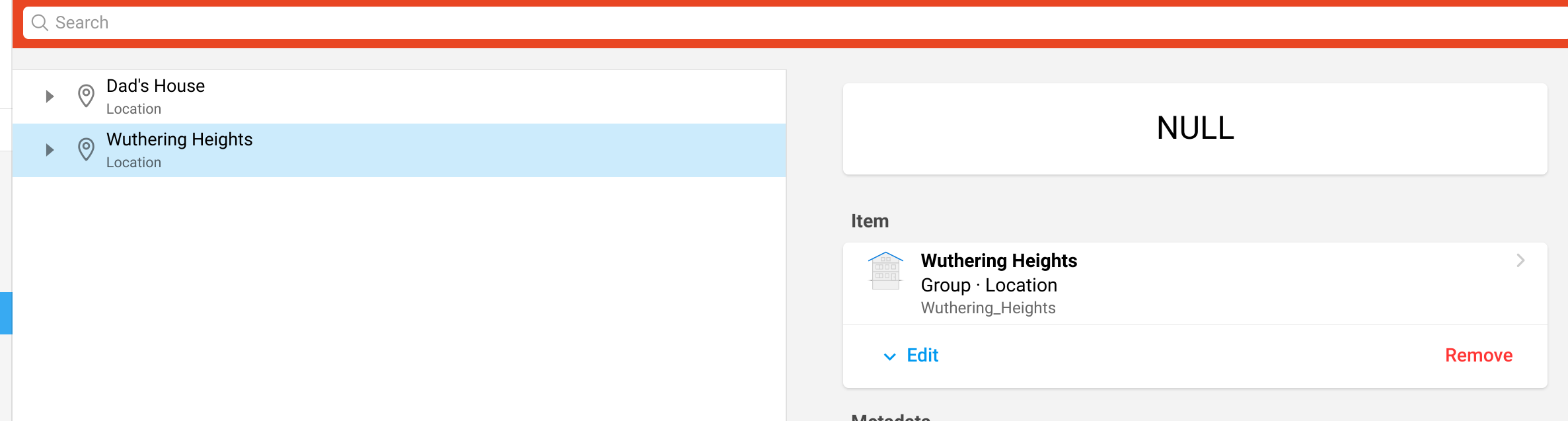

it’s “Group → Location”, the “direct members” are missing here. So it would be something for the wishlist! To have the group extra functionality also on “Location”.

I’m confused then. A Location is just a Group with a location tag. Find it in the Items settings page or click through to edit it from the Model view by selecting it and clicking the > icon to the right of the card to open the Item config page.

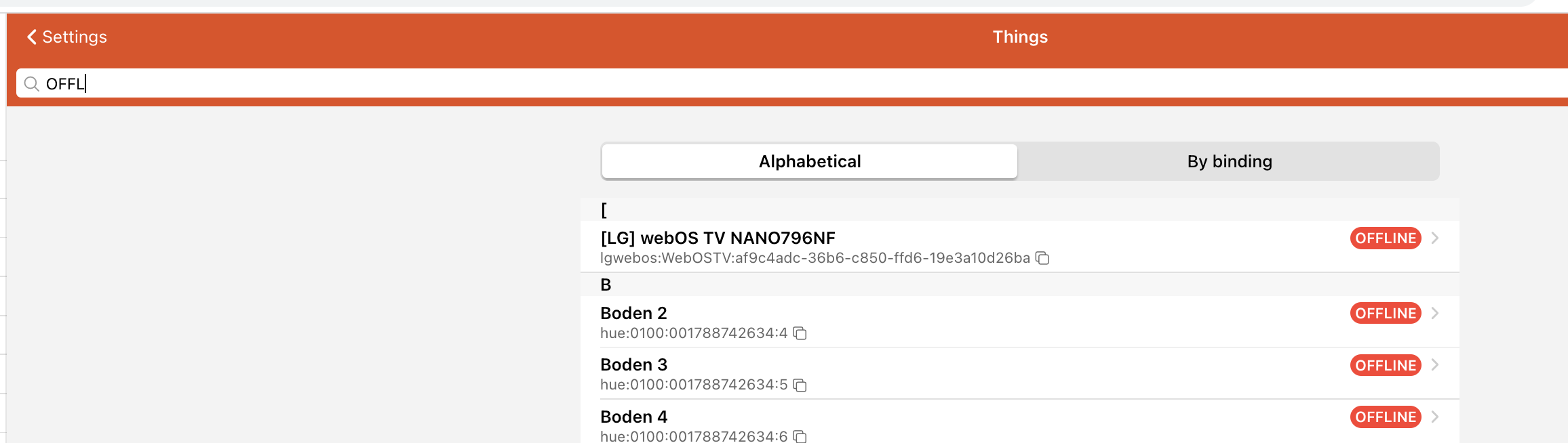

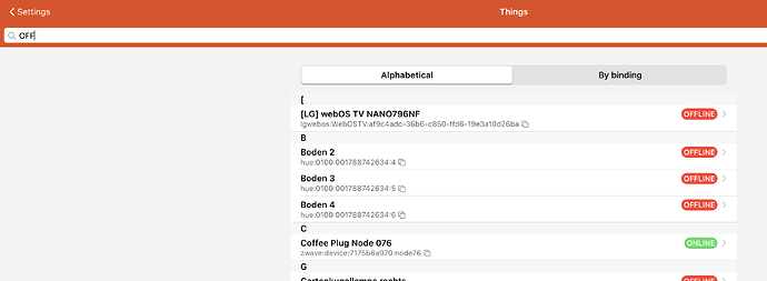

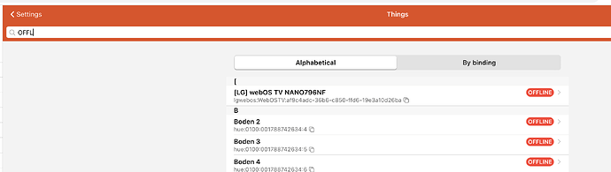

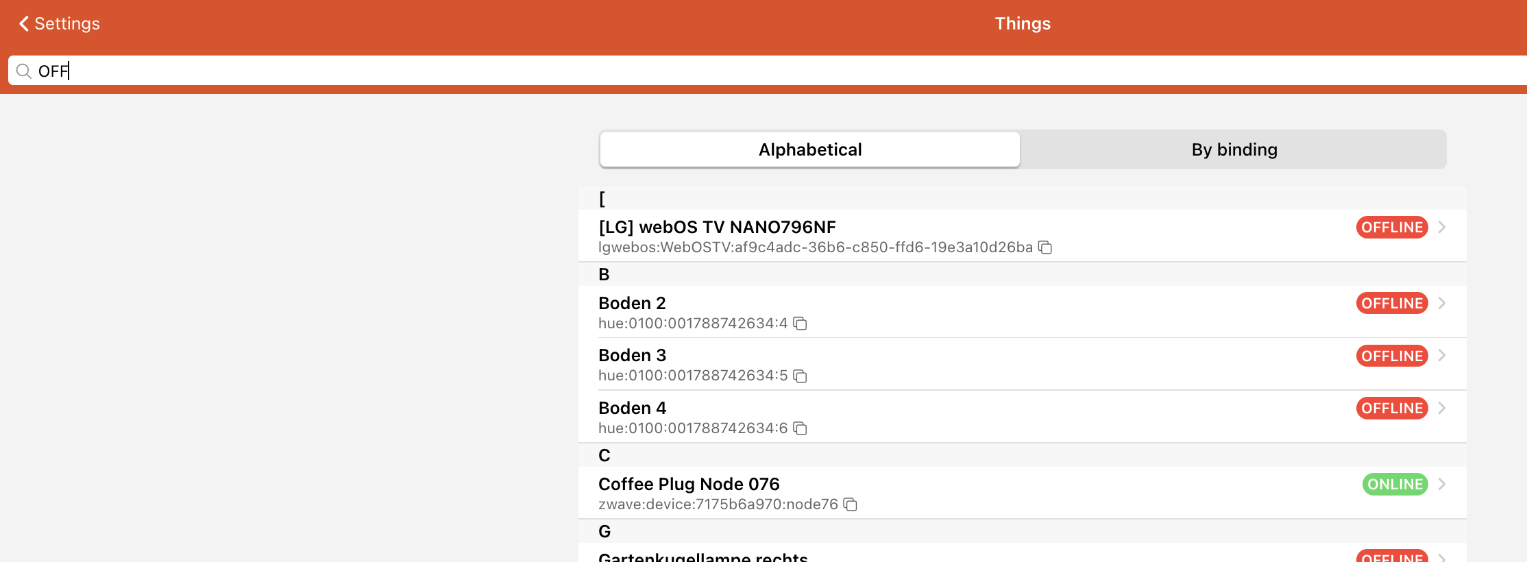

Mark, I think it already works good enough:
It actually searches over all text that it finds that is displayes which is why it also finds cOFFee when you search for OFF :wink:
The search bar doesn’t allow you to specify what parameter you want to search against but to me it works just fine.
