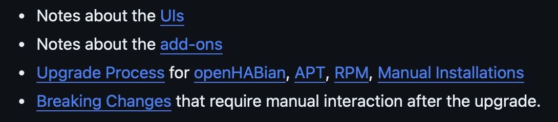

I just realized that all the following links in the release notes lead nowhere. The sections are missing:
It’s a GitHub bug because it works better if you open the full release notes:

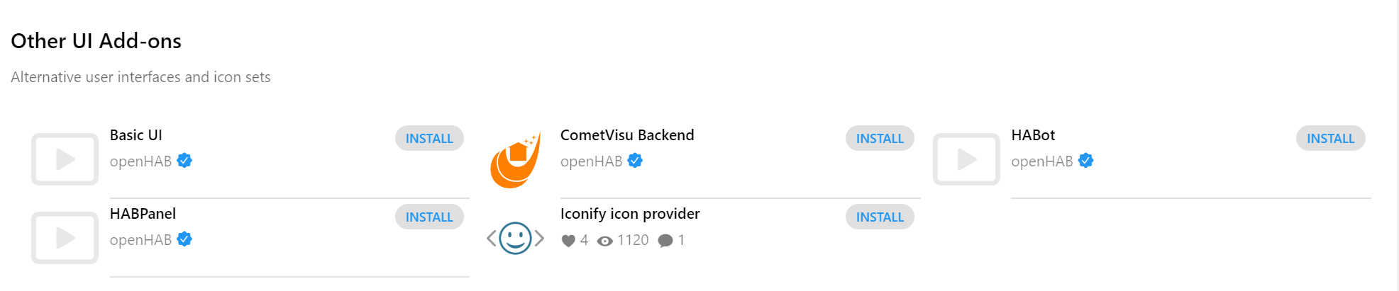

My openhab docker container upgraded automatically to 4.1 and i cannot install any new binding from the thing + button or from the add on store. If i click on the install button , i see a blue circle turning and turning, without any result.
Also there is no remove button in the add on store for already installed bindings in older version. All the old installed bindings have a blue install button instead of a remove button.
How can i fix this.

Did you restart the Container? is it in the host network or isolated in the bridge network?

Yes restart container, cleared cache and tmp files and restart container.
Is in host network on a Synology docker container.
Was working fine in all the previous versions since 3.xx and 4.xx

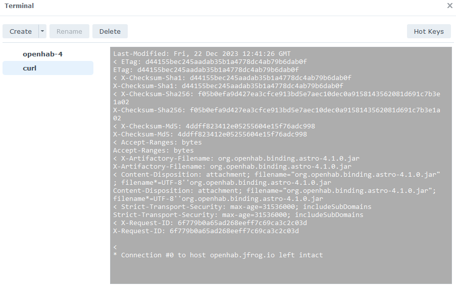

Maybe you can check if you can download add-ons using curl in the container?
E.g.:
docker exec openhab curl -v -I https://openhab.jfrog.io/artifactory/libs-release/org/openhab/addons/bundles/org.openhab.binding.astro/4.1.0/org.openhab.binding.astro-4.1.0.jar
You can remove “docker exec openhab” if you are in a shell in the container or replace “openhab” with your actual container name.
Run curl in container terminal .
Here is result:
It seems to work?

Patrick
Looks OK to me!

no luck with clearing cache browsers firefox and chrome.
Ctrl+F5 no result, no remove button cannot add new binding.
