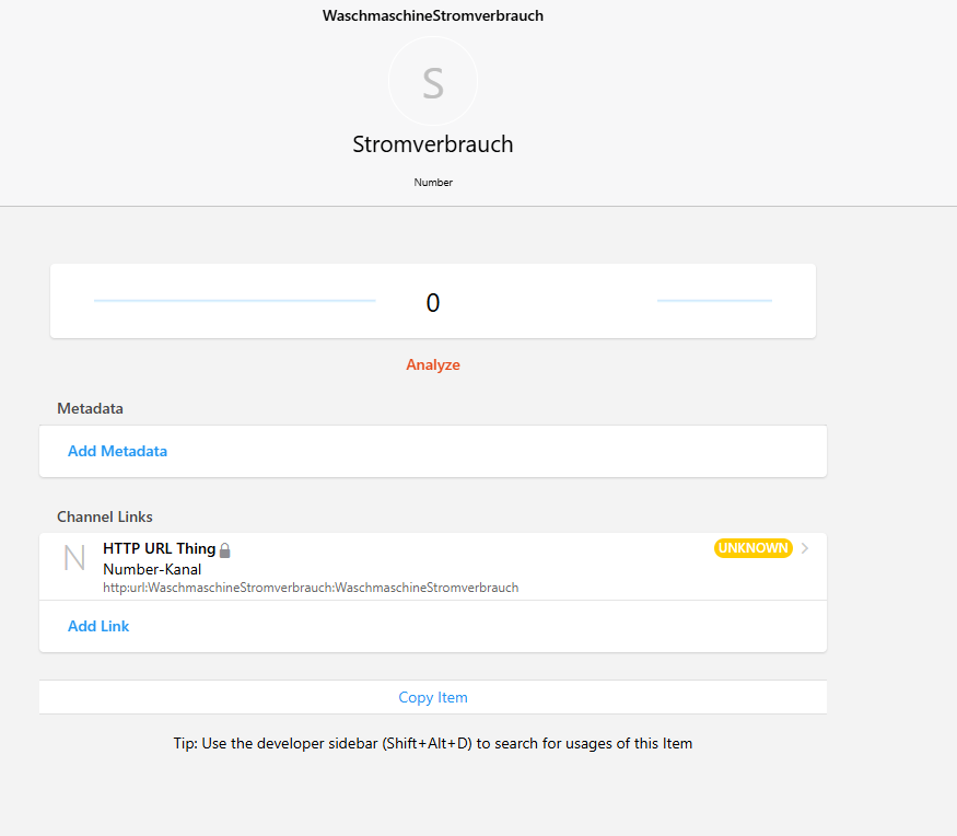

Hey Rich,
this is what it looks like in the UI:
The item is only updated when I remove and add it again - I guess it really receives the 0-Value then?

I meant in the list of Items.
What you see on the page of the screenshot is a transformed view of the state. But if you just click on Settings → Items the state shown in the list of all Items there is the raw state.

It also just shows 0.0
