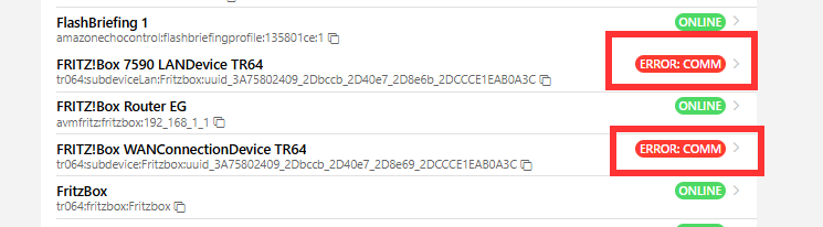

I update my Integration Instance from openhab 4.2.3 to 4.3.0 M5.
As a first finding, subdevices from TR064 Binding don’t get ONLINE:
Restarting Bundle doesn’t help.
I had to recreate the Subdevices and relink the items. Now the Things are ONLINE again

Weird as there does not seem to be a specific tr064 related PR. Anything noticeable in the logs?
No nothing. After Recreating the subdevices, everything fine now—
