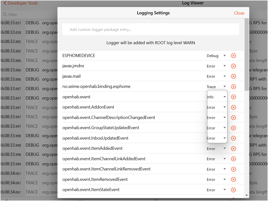

On my Windows laptop at home (so going to http://192.168.1.9:8080/), the logging does come through. If I go through https://myopenhab.org/ on the same laptop (on the same home network), the logging fails. So that’s where the problem seems to lay. And I assume the Android app always uses https://myopenhab.org/
A second problem, though. It shows all logs, which is too much :stuck_out_tongue: Luckily, you should be able to filter. But the dropdown menu is broken…
Edit: I later understood the filter only works after you stop the “tail”. Which makes sense of course. :slight_smile: But maybe it wouldn’t hurt to point that out for idiots like me :wink:

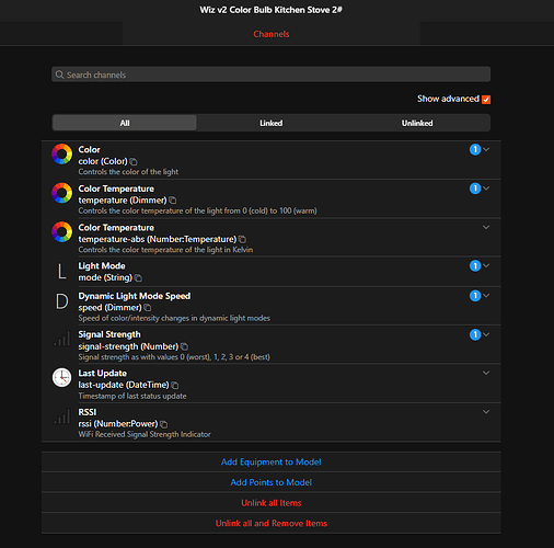

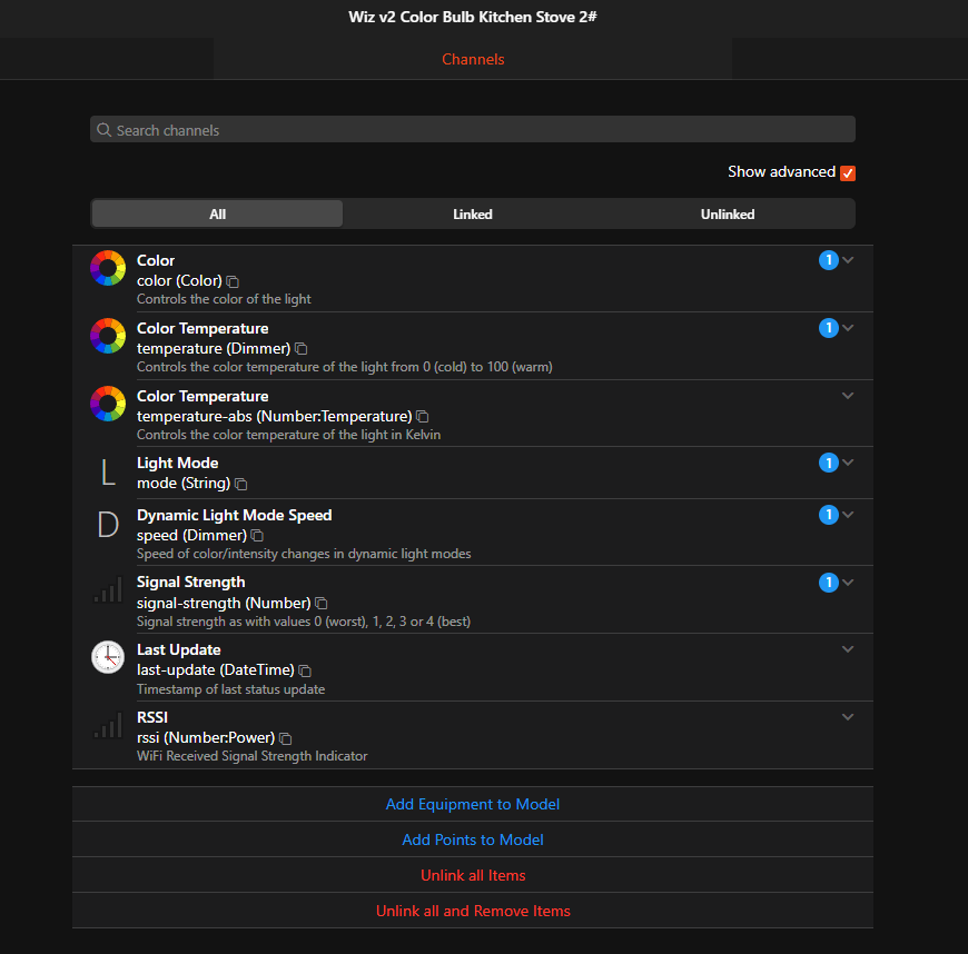

Hi all.
Just migrated all my legacy Wiz items to the new Wiz 4.3 binding. All works.. but i don’t have a Light State On/Off function or brightness 0-100
You can link such items to the color channel.
The Add On documentation specifically shows a brightness and power channel.
Using the color channel.. i cannot dim the white modes.
Can you please report this as issue on GitHub - openhab/openhab-webui: Web UIs of openHAB so we can have a look at it without forgetting it?

To be clear, once the ‘tail’ is stopped, the drop down menu does appear. Or do you mean it should also be there to filter the tail?
TBH I am not sure whether it should be configurable during the log tailing, or not.
Either way, the current state is not optimal so we should have a look and decide how to improve.

As mentioned above, the logging is not working with openHAB cloud.
https://github.com/openhab/openhab-cloud/issues/478
I suspect that this is being overloaded by heavy logging. I’ve seen similar, but not the same issue where if logging is coming in too fast for the logger to display, then the dropdown works, but it takes some time to catch up…
