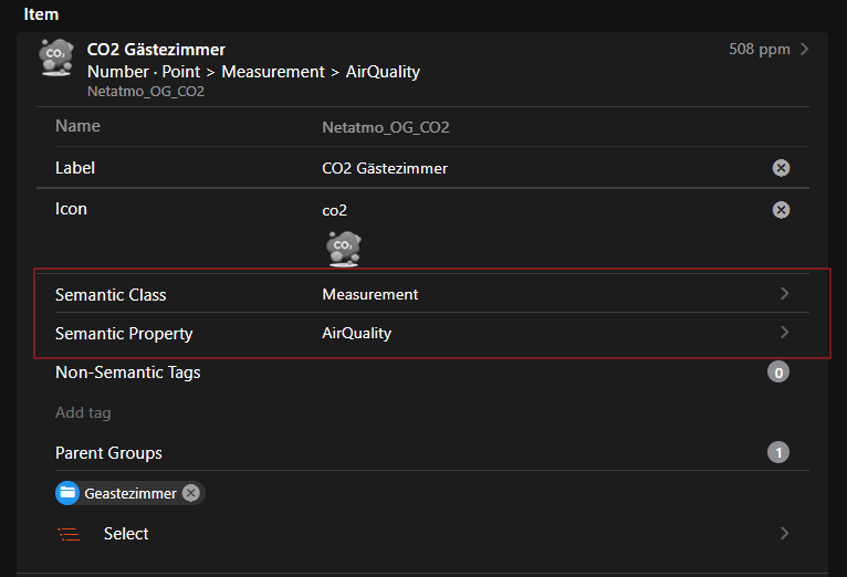

I’m a bit lost now. Can someone tell me what I need to set in M3 to see badges for “CO2 or now AirQuality” and Blinds? Whatever I try I can’t see these badges. Is this really wrong?
Why it is working for “Measurement/Temperature” but not for “Measurement/AirQuality” or like before “Measurement/CO2”?

Nothing. There is a fix that will appear in the next i.e. final milestone.
As @michaeljoos I’m a bit lost and will wait for MileStone. I hope my Window-Sensors will work(shown in Location-Card) again too.

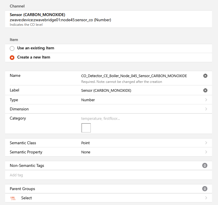

One more question regarding semantic tags: Does it make sense that the semantic class is always preset to “Point” when creating a new item? (I’ve tested this with various things and bindings and always preset the semantic class to “Point.”)
Or will the default be changed with OH 5.0?
For example an Z-Wave CO-Sensor:
In OH 5.0, bindings can now propose default tags for channels. These will be presented as defaults in the UI instead of Point and Property.
