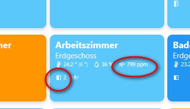

Jumping in here because I have the same problem with CO2 and open Blinds in M2 & M3:
This works:
This does not work (In my opinion correct setting?):

I guess nobody wrote a badge for CO2 yet?
I mean this one (ppm):
And it worked in 4.x.x:

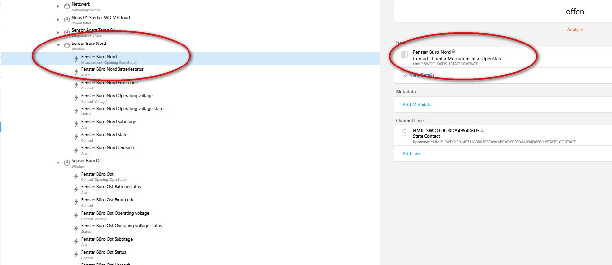

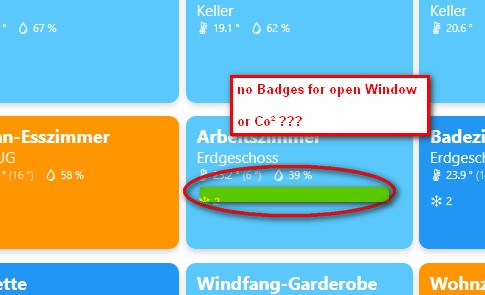

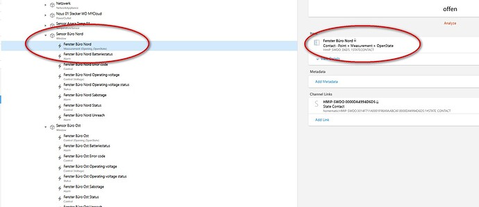

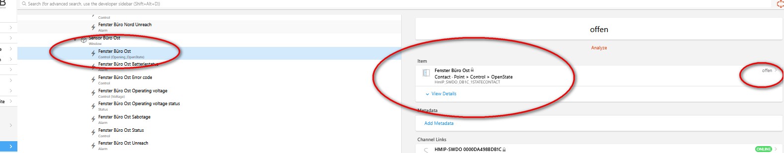

I have made several tests with the badges (open window and co²).

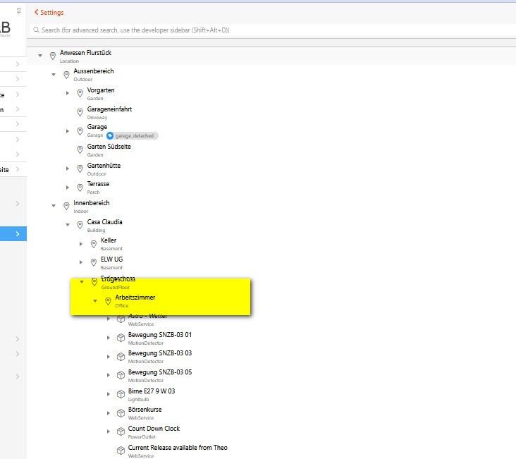

First a cutout of my semantic model (Büro/Arbeitszimmer) where the Equipments (Smokedetector and Window) are used.
Now the two Window-Sensors with open windows but no Badge in the Location card. I used one with and on without the Point “Measurement”
When using the tag “CO²” the Item isn’t shown in the semantic model !!!
And again the Location Card with no Badges

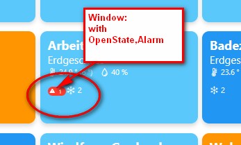

Only the combination OpenState/Alarm works, but not as expected in this case.
Hope my information can help a bit.
Cheers - Peter
