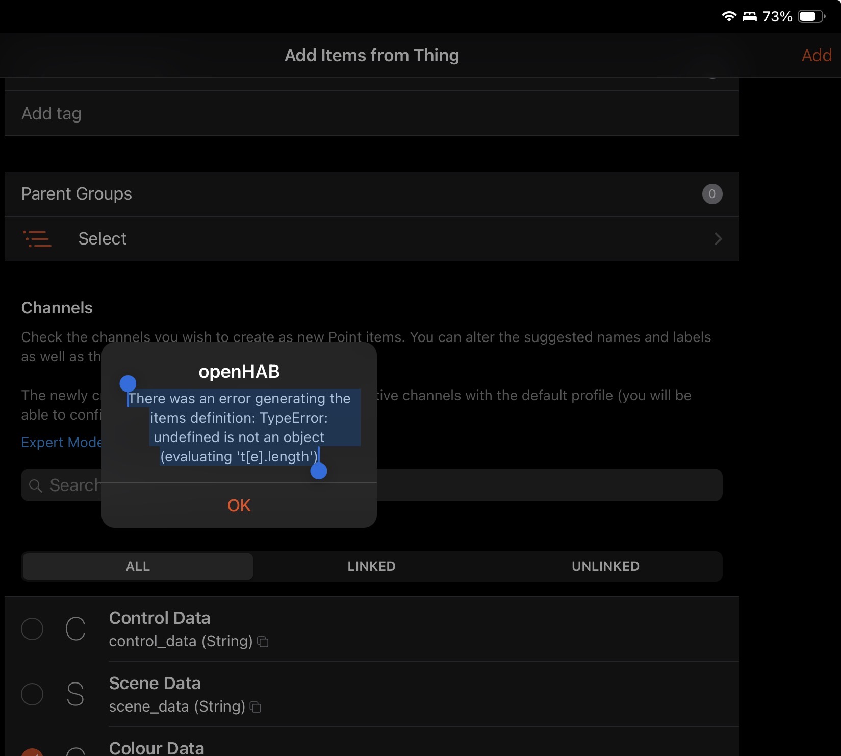

Perfekt, diesen Sceen sollte man in die Doku mit aufnehmen!!

In 5.0.3. It appears the add equipment from things is not working. When you go to select the channels to create the items from the thing. The usual sections to define the items do not appear when you check off the channel.
trying to use expert mode results in an error of
There was an error generating the items definition: TypeError: undefined is not an object (evaluating ‘t[e].length’)
upon further troubleshooting this maybe related to things created by the Tuya Binding.
