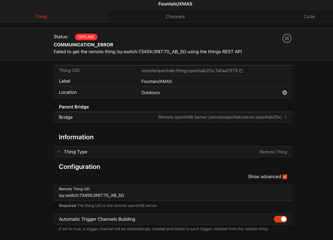

And please show the full status displayed by Main UI, you certainly have more info than just “Error Comm”. Do a screen capture.

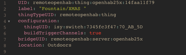

@Lolodomo thanks for looking into this. I have attached a Trace/Debug Log for when I was attempting to bring the Remote Thing ONLINE by toggling the Enable/Disable and Save. I am also including a couple of screen shots of the Thing specifications. I hope this helps, but if you need more/different information please let me know.

Are you sure to have setup properly the token parameter to access things from your remote server ?
Compare the definition of your remote openHAB main thing in OH4 abd OH5.

Unfortunately the binding is not logging the cause of the exception. So we don’t know why the REST API call fails in your case.
@Lolodomo just to followup I am running dockers on a 12 core 24 Virtual CPU Server 64 bit processors and 32 GB ram. I am pulling the containers from docker hub, so yes the containers have Java 21 and everything else in the installation is working the same as OH 4.3.5.
This morning I did as you suggested and tested OH 5 M3, but unfortunately it is also giving the same OFFLINE, ERROR.COMM for the Remote openHAB Thing. I also tried another approach to insure it was nothing related to the fact that I was upgrading from OH 4.3.5. Instead of performing a docker update. I created a clean OH 5 - snapshot install with no bindings or other config changes. Just plain vanilla install. I then added only the Remote openHAB binding and no other bindings. I then added the remote server and the Remote openHAB server went ONLINE. I then added a Remote openHAB Thing but unfortunately I got the same OFFLINE ERROR.COMM. Clicking th advanced box I saw that the “Authenticate Anyway” button was OFF. Enabling this feature brought the Remote openHAB Thing ONLINE, so at least now I know where to focus my attention.
SOLVED: For whatever reason, the Authenticate Anyway" button was OFF in my OH 5 upgrade from OH 4.3.5. I don’t remember turning it OFF but nonetheless that was the problem.
