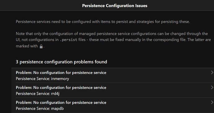

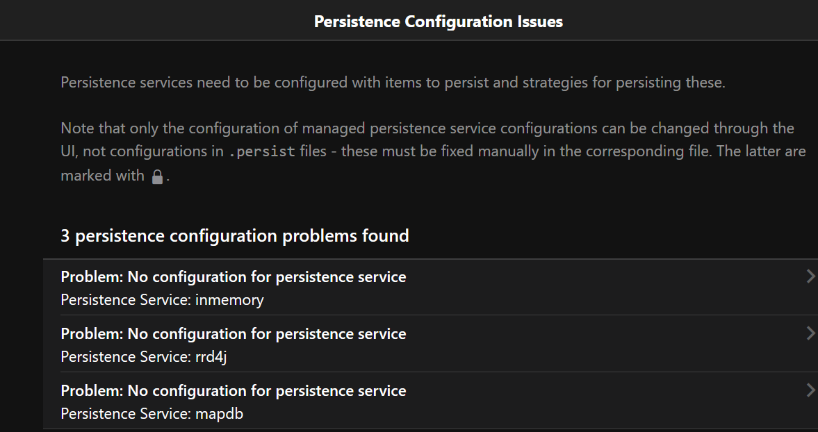

Health check also complains:
Looks like upgrade lost all persistence configuration.
