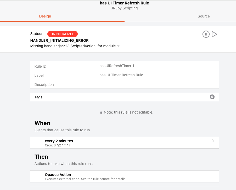

And yes - i see this error (i had not drilled down before since its a file based rule
PS the UI Based Rules are running and this is very definitely a ruby file(see screenshot)
Status:
UNINITIALIZED
HANDLER_INITIALIZING_ERROR
Missing handler β€˜jsr223.ScriptedAction’ for module β€˜1’
PS I also get an error connection the the karaf console via openhab-cli console and have to connect via SSH to localhost port 8101
(excuse the screenshot but you can see its a ruby file from the top)

220 β”‚ Active   β”‚  80 β”‚ 5.1.4                 β”‚ openHAB Core :: Bundles :: Persistence
221 β”‚ Active   β”‚  80 β”‚ 5.1.4                 β”‚ openHAB Core :: Bundles :: Semantics
222 β”‚ Active   β”‚  80 β”‚ 5.1.4                 β”‚ openHAB Core :: Bundles :: JSON Storage
223 β”‚ Active   β”‚  80 β”‚ 5.1.4                 β”‚ openHAB Core :: Bundles :: Thing
224 β”‚ Active   β”‚  80 β”‚ 5.1.4                 β”‚ openHAB Core :: Bundles :: Transformation Service
225 β”‚ Active   β”‚  80 β”‚ 5.1.4                 β”‚ openHAB Core :: Bundles :: UI
226 β”‚ Active   β”‚  80 β”‚ 5.1.4                 β”‚ openHAB Core :: Bundles :: UI Icon Support
227 β”‚ Active   β”‚  80 β”‚ 5.1.4                 β”‚ openHAB Core :: Bundles :: Voice
228 β”‚ Active   β”‚  80 β”‚ 5.1.4                 β”‚ openHAB UI :: Bundles :: Main UI
229 β”‚ Active   β”‚  80 β”‚ 5.1.4                 β”‚ openHAB UI :: Bundles :: Icon Set :: Classic
239 β”‚ Active   β”‚  80 β”‚ 1.5.1.202212101352    β”‚ org.osgi:org.osgi.service.component.annotations
240 β”‚ Active   β”‚  80 β”‚ 1.0.1.202109301733    β”‚ org.osgi:org.osgi.service.jaxrs
241 β”‚ Active   β”‚  80 β”‚ 1.8.0                 β”‚ ThreeTen-Extra
242 β”‚ Active   β”‚  80 β”‚ 2.4.0                 β”‚ SnakeYAML
243 β”‚ Active   β”‚  80 β”‚ 2.2.3                 β”‚ SI Quantity
244 β”‚ Active   β”‚  80 β”‚ 2.2.3                 β”‚ SI Units
245 β”‚ Active   β”‚  80 β”‚ 4.2.2                 β”‚ Stax2 API
246 β”‚ Active   β”‚  80 β”‚ 2.2.3                 β”‚ Units of Measurement Reference Implementation
247 β”‚ Active   β”‚  80 β”‚ 2.2.0                 β”‚ Units of Measurement Common Library for Java
248 β”‚ Active   β”‚  80 β”‚ 1.4.21                β”‚ XStream Core
305 β”‚ Active   β”‚  80 β”‚ 0.3.2                 β”‚ bluez-dbus-osgi
306 β”‚ Active   β”‚  80 β”‚ 2.3.2                 β”‚ big-math
307 β”‚ Active   β”‚  80 β”‚ 2.19.2                β”‚ Jackson datatype: jdk8
308 β”‚ Active   β”‚  80 β”‚ 2.42                  β”‚ Dagger
309 β”‚ Active   β”‚  80 β”‚ 1.2                   β”‚ RE2/J
310 β”‚ Active   β”‚  80 β”‚ 1.3.9                 β”‚ hivemq-mqtt-client
311 β”‚ Active   β”‚  80 β”‚ 1.9                   β”‚ Immutables Exceptions
312 β”‚ Active   β”‚  80 β”‚ 2.7.4                 β”‚ Jinjava
313 β”‚ Active   β”‚  80 β”‚ 5.17.0                β”‚ jna-platform
314 β”‚ Active   β”‚  80 β”‚ 1.6.2                 β”‚ JavaMail API
315 β”‚ Active   β”‚  80 β”‚ 4.1.126.Final         β”‚ Netty/Buffer
316 β”‚ Active   β”‚  80 β”‚ 4.1.126.Final         β”‚ Netty/Codec
317 β”‚ Active   β”‚  80 β”‚ 4.1.126.Final         β”‚ Netty/Codec/HTTP
318 β”‚ Active   β”‚  80 β”‚ 4.1.126.Final         β”‚ Netty/Codec/Socks
319 β”‚ Active   β”‚  80 β”‚ 4.1.126.Final         β”‚ Netty/Common
320 β”‚ Active   β”‚  80 β”‚ 4.1.126.Final         β”‚ Netty/Handler
321 β”‚ Active   β”‚  80 β”‚ 4.1.126.Final         β”‚ Netty/Handler/Proxy
322 β”‚ Active   β”‚  80 β”‚ 4.1.126.Final         β”‚ Netty/Resolver
323 β”‚ Active   β”‚  80 β”‚ 2.0.70.Final          β”‚ Netty/TomcatNative [OpenSSL - Classes]
324 β”‚ Active   β”‚  80 β”‚ 4.1.126.Final         β”‚ Netty/Transport
325 β”‚ Active   β”‚  80 β”‚ 4.1.126.Final         β”‚ Netty/Transport/Classes/Epoll
326 β”‚ Active   β”‚  80 β”‚ 4.1.126.Final         β”‚ Netty/Transport/Native/Unix/Common
327 β”‚ Active   β”‚  80 β”‚ 2.2.21                β”‚ rxjava
328 β”‚ Active   β”‚  80 β”‚ 1.0.1                 β”‚ IO.Socket Engine Client
329 β”‚ Active   β”‚  80 β”‚ 1.0.1                 β”‚ IO.Socket Socket Client
330 β”‚ Active   β”‚  80 β”‚ 1.0.5                 β”‚ Jakarta Dependency Injection
331 β”‚ Active   β”‚  80 β”‚ 3.30.2.GA             β”‚ Javassist
332 β”‚ Active   β”‚  80 β”‚ 20231013.0.0          β”‚ JSON in Java
333 β”‚ Active   β”‚  80 β”‚ 1.1.0                 β”‚ jxmpp-core
334 β”‚ Active   β”‚  80 β”‚ 1.1.0                 β”‚ jxmpp-jid
335 β”‚ Active   β”‚  80 β”‚ 1.1.0                 β”‚ jxmpp-util-cache
336 β”‚ Active   β”‚  80 β”‚ 1.1.1                 β”‚ minidns-core
337 β”‚ Active   β”‚  80 β”‚ 5.2.1.OH1             β”‚ nrjavaserial
338 β”‚ Active   β”‚  80 β”‚ 2.20.0                β”‚ Apache Commons IO
339 β”‚ Active   β”‚  80 β”‚ 3.12.0                β”‚ Apache Commons Net
340 β”‚ Active   β”‚  80 β”‚ 1.9.3                 β”‚ Apache OpenNLP Tools
341 β”‚ Active   β”‚  80 β”‚ 3.8.1.1               β”‚ Apache ServiceMix :: Bundles :: okhttp
342 β”‚ Active   β”‚  80 β”‚ 1.13.0.1              β”‚ Apache ServiceMix :: Bundles :: okio
343 β”‚ Active   β”‚  80 β”‚ 2.3.0                 β”‚ Apache Velocity - Engine
346 β”‚ Active   β”‚  80 β”‚ 25.0.1                β”‚ GraalVM :: Polyglot :: Polyglot
347 β”‚ Active   β”‚  80 β”‚ 25.0.1                β”‚ GraalVM :: Python :: Embedding
348 β”‚ Active   β”‚  78 β”‚ 25.0.1                β”‚ GraalVM :: Python :: Language
349 β”‚ Active   β”‚  78 β”‚ 25.0.1                β”‚ GraalVM :: Python :: Resources
350 β”‚ Active   β”‚  78 β”‚ 25.0.1                β”‚ GraalVM :: Regex :: TRegex
351 β”‚ Active   β”‚  80 β”‚ 25.0.1                β”‚ GraalVM :: SDK :: Collections
352 β”‚ Active   β”‚  80 β”‚ 25.0.1                β”‚ GraalVM :: SDK :: Native Image
353 β”‚ Active   β”‚  80 β”‚ 25.0.1                β”‚ GraalVM :: SDK :: Word
354 β”‚ Active   β”‚  80 β”‚ 25.0.1                β”‚ GraalVM :: Truffle :: ICU4J
355 β”‚ Active   β”‚  80 β”‚ 25.0.1                β”‚ GraalVM :: Truffle :: JSON
356 β”‚ Active   β”‚  80 β”‚ 25.0.1                β”‚ GraalVM :: Truffle :: XZ
357 β”‚ Active   β”‚  80 β”‚ 25.0.1                β”‚ GraalVM :: Tools :: Profiler
358 β”‚ Active   β”‚  79 β”‚ 25.0.1                β”‚ GraalVM :: Truffle :: API
359 β”‚ Active   β”‚  80 β”‚ 25.0.1                β”‚ GraalVM :: Truffle :: Compiler
360 β”‚ Active   β”‚  80 β”‚ 25.0.1                β”‚ GraalVM :: Truffle :: NFI
361 β”‚ Active   β”‚  80 β”‚ 25.0.1                β”‚ GraalVM :: Truffle :: Runtime
362 β”‚ Active   β”‚  80 β”‚ 0.2                   β”‚ hsluv
364 β”‚ Active   β”‚  80 β”‚ 2.1.2                 β”‚ Java Concurrency Tools Core Library
365 β”‚ Active   β”‚  80 β”‚ 1.14.3                β”‚ jsoup Java HTML Parser
366 β”‚ Active   β”‚  80 β”‚ 3.0.4                 β”‚ jUPnP Core Library
367 β”‚ Waiting  β”‚  80 β”‚ 5.1.4                 β”‚ openHAB Add-ons :: Bundles :: Automation :: JRuby Scripting
369 β”‚ Active   β”‚  80 β”‚ 5.1.4                 β”‚ openHAB Add-ons :: Bundles :: Airquality Binding
370 β”‚ Active   β”‚  80 β”‚ 5.1.4                 β”‚ openHAB Add-ons :: Bundles :: Amazon Echo Control Binding
371 β”‚ Active   β”‚  80 β”‚ 5.1.4                 β”‚ openHAB Add-ons :: Bundles :: Android Debug Bridge Binding
372 β”‚ Active   β”‚  80 β”‚ 5.1.4                 β”‚ openHAB Add-ons :: Bundles :: AndroidTV Binding
373 β”‚ Active   β”‚  80 β”‚ 5.1.4                 β”‚ openHAB Add-ons :: Bundles :: Astro Binding
374 β”‚ Active   β”‚  80 β”‚ 5.1.4                 β”‚ openHAB Add-ons :: Bundles :: Bluetooth Binding
375 β”‚ Active   β”‚  80 β”‚ 5.1.4                 β”‚ openHAB Add-ons :: Bundles :: Airthings Bluetooth Adapter
376 β”‚ Active   β”‚  80 β”‚ 5.1.4                 β”‚ openHAB Add-ons :: Bundles :: AM43 Bluetooth Adapter
377 β”‚ Active   β”‚  80 β”‚ 5.1.4                 β”‚ openHAB Add-ons :: Bundles :: BlueGiga Bluetooth Adapter
378 β”‚ Active   β”‚  80 β”‚ 5.1.4                 β”‚ openHAB Add-ons :: Bundles :: BlueZ Bluetooth Adapter
379 β”‚ Active   β”‚  80 β”‚ 5.1.4                 β”‚ openHAB Add-ons :: Bundles :: Blukii Bluetooth Adapter
380 β”‚ Active   β”‚  80 β”‚ 5.1.4                 β”‚ openHAB Add-ons :: Bundles :: DaikinMadoka Bluetooth Adapter
381 β”‚ Active   β”‚  80 β”‚ 5.1.4                 β”‚ openHAB Add-ons :: Bundles :: EnOcean Bluetooth Adapter
382 β”‚ Active   β”‚  80 β”‚ 5.1.4                 β”‚ openHAB Add-ons :: Bundles :: Generic Bluetooth Adapter
383 β”‚ Active   β”‚  80 β”‚ 5.1.4                 β”‚ openHAB Add-ons :: Bundles :: Govee Bluetooth Adapter
384 β”‚ Active   β”‚  80 β”‚ 5.1.4                 β”‚ openHAB Add-ons :: Bundles :: Grundfos Alpha Bluetooth Adapter
385 β”‚ Active   β”‚  80 β”‚ 5.1.4                 β”‚ openHAB Add-ons :: Bundles :: HD Powerview Bluetooth Adapter
386 β”‚ Active   β”‚  80 β”‚ 5.1.4                 β”‚ openHAB Add-ons :: Bundles :: Bluetooth Listener Binding
387 β”‚ Active   β”‚  80 β”‚ 5.1.4                 β”‚ openHAB Add-ons :: Bundles :: RadonEye Bluetooth Adapter
388 β”‚ Active   β”‚  80 β”‚ 5.1.4                 β”‚ openHAB Add-ons :: Bundles :: Roaming Bluetooth Adapter
389 β”‚ Active   β”‚  80 β”‚ 5.1.4                 β”‚ openHAB Add-ons :: Bundles :: RuuviTag Bluetooth Adapter
390 β”‚ Resolved β”‚  80 β”‚ 5.1.4                 β”‚ openHAB Add-ons :: Bundles :: ChatGPT Binding
391 β”‚ Active   β”‚  80 β”‚ 5.1.4                 β”‚ openHAB Add-ons :: Bundles :: Chromecast Binding
392 β”‚ Active   β”‚  80 β”‚ 5.1.4                 β”‚ openHAB Add-ons :: Bundles :: D-Link Smart Home Binding
393 β”‚ Active   β”‚  80 β”‚ 5.1.4                 β”‚ openHAB Add-ons :: Bundles :: ENTSO-E Binding
394 β”‚ Active   β”‚  80 β”‚ 5.1.4                 β”‚ openHAB Add-ons :: Bundles :: Ephemeris Binding
395 β”‚ Active   β”‚  80 β”‚ 5.1.4                 β”‚ openHAB Add-ons :: Bundles :: evcc Binding
396 β”‚ Active   β”‚  80 β”‚ 5.1.4                 β”‚ openHAB Add-ons :: Bundles :: Exec Binding
397 β”‚ Active   β”‚  80 β”‚ 5.1.4                 β”‚ openHAB Add-ons :: Bundles :: Freecurrency Binding
398 β”‚ Active   β”‚  81 β”‚ 5.1.4                 β”‚ openHAB Add-ons :: Bundles :: Home Assistant Binding
399 β”‚ Active   β”‚  80 β”‚ 5.1.4                 β”‚ openHAB Add-ons :: Bundles :: HomeKit Client Binding
400 β”‚ Active   β”‚  81 β”‚ 5.1.4                 β”‚ openHAB Add-ons :: Bundles :: Homie Convention Binding
401 β”‚ Active   β”‚  80 β”‚ 5.1.4                 β”‚ openHAB Add-ons :: Bundles :: HP Printer Binding
402 β”‚ Active   β”‚  80 β”‚ 5.1.4                 β”‚ openHAB Add-ons :: Bundles :: HTTP Binding
403 β”‚ Active   β”‚  80 β”‚ 5.1.4                 β”‚ openHAB Add-ons :: Bundles :: hue Binding
404 β”‚ Active   β”‚  80 β”‚ 5.1.4                 β”‚ openHAB Add-ons :: Bundles :: Hue Sync Box Binding
405 β”‚ Active   β”‚  80 β”‚ 5.1.4                 β”‚ openHAB Add-ons :: Bundles :: iCalendar Binding
406 β”‚ Active   β”‚  80 β”‚ 5.1.4                 β”‚ openHAB Add-ons :: Bundles :: iCloud Binding
407 β”‚ Active   β”‚  80 β”‚ 5.1.4                 β”‚ openHAB Add-ons :: Bundles :: IpCamera Binding
408 β”‚ Active   β”‚  80 β”‚ 5.1.4                 β”‚ openHAB Add-ons :: Bundles :: IPP Binding
409 β”‚ Active   β”‚  80 β”‚ 5.1.4                 β”‚ openHAB Add-ons :: Bundles :: Kodi Binding
410 β”‚ Active   β”‚  80 β”‚ 5.1.4                 β”‚ openHAB Add-ons :: Bundles :: Kostal Binding
411 β”‚ Active   β”‚  80 β”‚ 5.1.4                 β”‚ openHAB Add-ons :: Bundles :: LG webOS Binding
412 β”‚ Active   β”‚  80 β”‚ 5.1.4                 β”‚ openHAB Add-ons :: Bundles :: Log Reader Binding
413 β”‚ Active   β”‚  80 β”‚ 5.1.4                 β”‚ openHAB Add-ons :: Bundles :: Mail Binding
414 β”‚ Active   β”‚  80 β”‚ 5.1.4                 β”‚ openHAB Add-ons :: Bundles :: Matter Binding
415 β”‚ Active   β”‚  80 β”‚ 5.1.4                 β”‚ openHAB Add-ons :: Bundles :: Modbus Binding
416 β”‚ Active   β”‚  80 β”‚ 5.1.4                 β”‚ openHAB Add-ons :: Bundles :: E3DC Modbus Binding
417 β”‚ Active   β”‚  80 β”‚ 5.1.4                 β”‚ openHAB Add-ons :: Bundles :: Modbus FoxInverter Binding
418 β”‚ Active   β”‚  80 β”‚ 5.1.4                 β”‚ openHAB Add-ons :: Bundles :: HeliosEasyControls Binding
419 β”‚ Active   β”‚  80 β”‚ 5.1.4                 β”‚ openHAB Add-ons :: Bundles :: Kermi Modbus Binding
420 β”‚ Active   β”‚  80 β”‚ 5.1.4                 β”‚ openHAB Add-ons :: Bundles :: Lambda Binding
421 β”‚ Active   β”‚  80 β”‚ 5.1.4                 β”‚ openHAB Add-ons :: Bundles :: Modbus SBC Binding
422 β”‚ Active   β”‚  80 β”‚ 5.1.4                 β”‚ openHAB Add-ons :: Bundles :: StiebelEltron Bundle
423 β”‚ Active   β”‚  80 β”‚ 5.1.4                 β”‚ openHAB Add-ons :: Bundles :: Studer Binding
424 β”‚ Active   β”‚  80 β”‚ 5.1.4                 β”‚ openHAB Add-ons :: Bundles :: Modbus Sungrow Binding
425 β”‚ Active   β”‚  80 β”‚ 5.1.4                 β”‚ openHAB Add-ons :: Bundles :: SunSpec Bundle
426 β”‚ Active   β”‚  80 β”‚ 5.1.4                 β”‚ openHAB Add-ons :: Bundles :: MPD Binding
427 β”‚ Active   β”‚  80 β”‚ 5.1.4                 β”‚ openHAB Add-ons :: Bundles :: MQTT Broker Binding
428 β”‚ Active   β”‚  81 β”‚ 5.1.4                 β”‚ openHAB Add-ons :: Bundles :: MQTT Awtrix 3
429 β”‚ Active   β”‚  81 β”‚ 5.1.4                 β”‚ openHAB Add-ons :: Bundles :: MQTT EspMilightHub
430 β”‚ Active   β”‚  81 β”‚ 5.1.4                 β”‚ openHAB Add-ons :: Bundles :: MQTT FPP
431 β”‚ Active   β”‚  81 β”‚ 5.1.4                 β”‚ openHAB Add-ons :: Bundles :: MQTT Ruuvi Gateway
432 β”‚ Active   β”‚  80 β”‚ 5.1.4                 β”‚ openHAB Add-ons :: Bundles :: Netatmo Binding
433 β”‚ Active   β”‚  80 β”‚ 5.1.4                 β”‚ openHAB Add-ons :: Bundles :: Network Binding
434 β”‚ Active   β”‚  80 β”‚ 5.1.4                 β”‚ openHAB Add-ons :: Bundles :: Network UPS Tools Binding
435 β”‚ Active   β”‚  80 β”‚ 5.1.4                 β”‚ openHAB Add-ons :: Bundles :: OpenUV Binding
436 β”‚ Active   β”‚  80 β”‚ 5.1.4                 β”‚ openHAB Add-ons :: Bundles :: OpenWeatherMap Binding
437 β”‚ Active   β”‚  80 β”‚ 5.1.4                 β”‚ openHAB Add-ons :: Bundles :: Prowl Binding
438 β”‚ Active   β”‚  80 β”‚ 5.1.4                 β”‚ openHAB Add-ons :: Bundles :: Pushover Binding
439 β”‚ Active   β”‚  80 β”‚ 5.1.4                 β”‚ openHAB Add-ons :: Bundles :: SNMP Binding
440 β”‚ Active   β”‚  80 β”‚ 5.1.4                 β”‚ openHAB Add-ons :: Bundles :: SolarForecast Binding
441 β”‚ Active   β”‚  80 β”‚ 5.1.4                 β”‚ openHAB Add-ons :: Bundles :: Speedtest Binding
442 β”‚ Active   β”‚  80 β”‚ 5.1.4                 β”‚ openHAB Add-ons :: Bundles :: SystemInfo Binding
443 β”‚ Active   β”‚  80 β”‚ 5.1.4                 β”‚ openHAB Add-ons :: Bundles :: TapoControl Binding
444 β”‚ Active   β”‚  80 β”‚ 5.1.4                 β”‚ openHAB Add-ons :: Bundles :: Tasmota Plug Binding
445 β”‚ Active   β”‚  80 β”‚ 5.1.4                 β”‚ openHAB Add-ons :: Bundles :: Tuya Binding
446 β”‚ Active   β”‚  80 β”‚ 5.1.4                 β”‚ openHAB Add-ons :: Bundles :: UPnP Control Binding
447 β”‚ Active   β”‚  80 β”‚ 5.1.4                 β”‚ openHAB Add-ons :: Bundles :: WeatherCompany Binding
448 β”‚ Active   β”‚  80 β”‚ 5.1.4                 β”‚ openHAB Add-ons :: Bundles :: WeatherUnderground Binding
449 β”‚ Active   β”‚  80 β”‚ 5.1.4                 β”‚ openHAB Add-ons :: Bundles :: XMPPClient Binding
450 β”‚ Active   β”‚  80 β”‚ 5.1.4                 β”‚ openHAB Core :: Bundles :: IP-based Suggested Add-on Finder
451 β”‚ Active   β”‚  80 β”‚ 5.1.4                 β”‚ openHAB Core :: Bundles :: mDNS Suggested Add-on Finder
452 β”‚ Active   β”‚  80 β”‚ 5.1.4                 β”‚ openHAB Core :: Bundles :: SDDP Suggested Add-on Finder
453 β”‚ Active   β”‚  80 β”‚ 5.1.4                 β”‚ openHAB Core :: Bundles :: uPnP Suggested Add-on Finder
454 β”‚ Active   β”‚  80 β”‚ 5.1.4                 β”‚ openHAB Core :: Bundles :: USB Suggested Add-on Finder
456 β”‚ Active   β”‚  80 β”‚ 5.1.4                 β”‚ openHAB Core :: Bundles :: Configuration SDDP Discovery
458 β”‚ Active   β”‚  80 β”‚ 5.1.4                 β”‚ openHAB Core :: Bundles :: Configuration UPnP Discovery
460 β”‚ Active   β”‚  80 β”‚ 5.1.4                 β”‚ openHAB Core :: Bundles :: Configuration USB-Serial Discovery
462 β”‚ Active   β”‚  80 β”‚ 5.1.4                 β”‚ openHAB Core :: Bundles :: Configuration USB-Serial Discovery for Linux using sysfs scanning
464 β”‚ Active   β”‚  80 β”‚ 5.1.4                 β”‚ openHAB Core :: Bundles :: Configuration USB-Serial Discovery using ser2net mDNS scanning
466 β”‚ Active   β”‚  80 β”‚ 5.1.4                 β”‚ openHAB Core :: Bundles :: Configuration USB-Serial Discovery for Windows
468 β”‚ Active   β”‚  80 β”‚ 5.1.4                 β”‚ openHAB Core :: Bundles :: Configuration Serial
469 β”‚ Active   β”‚  80 β”‚ 5.1.4                 β”‚ openHAB Core :: Bundles :: Modbus Transport
470 β”‚ Active   β”‚  80 β”‚ 5.1.4                 β”‚ openHAB Core :: Bundles :: MQTT Transport
472 β”‚ Active   β”‚  80 β”‚ 5.1.4                 β”‚ openHAB Core :: Bundles :: Serial Transport
474 β”‚ Active   β”‚  80 β”‚ 5.1.4                 β”‚ openHAB Core :: Bundles :: Serial Transport for RXTX
476 β”‚ Active   β”‚  80 β”‚ 5.1.4                 β”‚ openHAB Core :: Bundles :: Serial Transport for RFC2217
478 β”‚ Active   β”‚  80 β”‚ 5.1.4                 β”‚ openHAB Core :: Bundles :: UPnP Transport
479 β”‚ Active   β”‚  80 β”‚ 5.1.4                 β”‚ openHAB Add-ons :: Bundles :: IO :: Homekit
480 β”‚ Active   β”‚  80 β”‚ 5.1.4                 β”‚ openHAB Add-ons :: Bundles :: IO :: Metrics Service
481 β”‚ Resolved β”‚  80 β”‚ 5.1.4                 β”‚ openHAB Add-ons :: Bundles :: IO :: openHAB Cloud Connector
482 β”‚ Active   β”‚  80 β”‚ 5.1.4                 β”‚ openHAB Add-ons :: Bundles :: Persistence Service :: InMemory
483 β”‚ Active   β”‚  80 β”‚ 5.1.4                 β”‚ openHAB Add-ons :: Bundles :: Persistence Service :: MapDB
484 β”‚ Resolved β”‚  80 β”‚ 5.1.4                 β”‚ openHAB Add-ons :: Bundles :: Persistence Service :: RRD4j
485 β”‚ Active   β”‚  75 β”‚ 5.1.4                 β”‚ openHAB Add-ons :: Bundles :: Transformation Service :: Basic Profiles
486 β”‚ Active   β”‚  75 β”‚ 5.1.4                 β”‚ openHAB Add-ons :: Bundles :: Transformation Service :: Jinja
487 β”‚ Active   β”‚  75 β”‚ 5.1.4                 β”‚ openHAB Add-ons :: Bundles :: Transformation Service :: JSonPath
488 β”‚ Active   β”‚  75 β”‚ 5.1.4                 β”‚ openHAB Add-ons :: Bundles :: Transformation Service :: Map
489 β”‚ Active   β”‚  75 β”‚ 5.1.4                 β”‚ openHAB Add-ons :: Bundles :: Transformation Service :: RegEx
490 β”‚ Active   β”‚  75 β”‚ 5.1.4                 β”‚ openHAB Add-ons :: Bundles :: Transformation Service :: XPath
491 β”‚ Resolved β”‚  80 β”‚ 5.1.4                 β”‚ openHAB UI :: Bundles :: Basic UI
492 β”‚ Resolved β”‚  80 β”‚ 5.1.4                 β”‚ openHAB UI :: Bundles :: CometVisu :: Backend
493 β”‚ Resolved β”‚  80 β”‚ 5.1.4                 β”‚ openHAB UI :: Bundles :: HABot Interactive Bot
494 β”‚ Resolved β”‚  80 β”‚ 5.1.4                 β”‚ openHAB UI :: Bundles :: HABPanel UI
495 β”‚ Active   β”‚  80 β”‚ 5.1.4                 β”‚ openHAB Add-ons :: Bundles :: Voice :: VoiceRSS Text-to-Speech
496 β”‚ Active   β”‚  80 β”‚ 1.0.4                 β”‚ reactive-streams-jvm
497 β”‚ Active   β”‚  80 β”‚ 3.8.2                 β”‚ RRD4J
512 β”‚ Active   β”‚  80 β”‚ 5.1.3                 β”‚ openHAB Add-ons :: Bundles :: ddwrt Binding
513 β”‚ Waiting  β”‚  80 β”‚ 5.1.3                 β”‚ openHAB Core :: Bundles :: Core
514 β”‚ Active   β”‚  80 β”‚ 5.1.3                 β”‚ openHAB Core :: Bundles :: Add-on XML
515 β”‚ Resolved β”‚  80 β”‚ 5.1.3                 β”‚ openHAB Core :: Bundles :: Marketplace Add-on Services
516 β”‚ Resolved β”‚  80 β”‚ 5.1.3                 β”‚ openHAB Core :: Bundles :: Community Marketplace Add-on Service :: Karaf
517 β”‚ Active   β”‚  80 β”‚ 5.1.3                 β”‚ openHAB Core :: Bundles :: Audio
518 β”‚ Active   β”‚  80 β”‚ 5.1.3                 β”‚ openHAB Core :: Bundles :: JAAS Authentication
519 β”‚ Active   β”‚  80 β”‚ 5.1.3                 β”‚ openHAB Core :: Bundles :: OAuth2Client
520 β”‚ Active   β”‚  80 β”‚ 5.1.3                 β”‚ openHAB Core :: Bundles :: Automation
521 β”‚ Active   β”‚  80 β”‚ 5.1.3                 β”‚ openHAB Core :: Bundles :: Automation Media Modules
522 β”‚ Active   β”‚  80 β”‚ 5.1.3                 β”‚ openHAB Core :: Bundles :: Automation Script Modules
523 β”‚ Active   β”‚  80 β”‚ 5.1.3                 β”‚ openHAB Core :: Bundles :: Automation Script ProviderSupport
524 β”‚ Waiting  β”‚  80 β”‚ 5.1.3                 β”‚ openHAB Core :: Bundles :: Automation Script RuleSupport
525 β”‚ Active   β”‚  80 β”‚ 5.1.3                 β”‚ openHAB Core :: Bundles :: Configuration Core
526 β”‚ Active   β”‚  80 β”‚ 5.1.3                 β”‚ openHAB Core :: Bundles :: Configuration Discovery
527 β”‚ Active   β”‚  80 β”‚ 5.1.3                 β”‚ openHAB Core :: Bundles :: Process-based Suggested Add-on Finder
528 β”‚ Active   β”‚  80 β”‚ 5.1.3                 β”‚ openHAB Core :: Bundles :: Configuration mDNS Discovery
529 β”‚ Active   β”‚  80 β”‚ 5.1.3                 β”‚ openHAB Core :: Bundles :: Configuration SDDP Discovery
530 β”‚ Active   β”‚  80 β”‚ 5.1.3                 β”‚ openHAB Core :: Bundles :: Configuration UPnP Discovery
531 β”‚ Active   β”‚  80 β”‚ 5.1.3                 β”‚ openHAB Core :: Bundles :: Configuration USB-Serial Discovery
532 β”‚ Waiting  β”‚  80 β”‚ 5.1.3                 β”‚ openHAB Core :: Bundles :: Configuration USB-Serial Discovery for Linux using sysfs scanning
533 β”‚ Active   β”‚  80 β”‚ 5.1.3                 β”‚ openHAB Core :: Bundles :: Configuration USB-Serial Discovery using ser2net mDNS scanning
534 β”‚ Active   β”‚  80 β”‚ 5.1.3                 β”‚ openHAB Core :: Bundles :: Configuration USB-Serial Discovery for Windows
535 β”‚ Waiting  β”‚  80 β”‚ 5.1.3                 β”‚ openHAB Core :: Bundles :: Configuration Dispatcher
536 β”‚ Active   β”‚  80 β”‚ 5.1.3                 β”‚ openHAB Core :: Bundles :: Configuration Serial
537 β”‚ Active   β”‚  80 β”‚ 5.1.3                 β”‚ openHAB Core :: Bundles :: Ephemeris
538 β”‚ Active   β”‚  80 β”‚ 5.1.3                 β”‚ openHAB Core :: Bundles :: ID
539 β”‚ Active   β”‚  80 β”‚ 5.1.3                 β”‚ openHAB Core :: Bundles :: Console
540 β”‚ Active   β”‚  80 β”‚ 5.1.3                 β”‚ openHAB Core :: Bundles :: HTTP Interface
541 β”‚ Active   β”‚  80 β”‚ 5.1.3                 β”‚ openHAB Core :: Bundles :: HTTP Interface Authentication
542 β”‚ Active   β”‚  80 β”‚ 5.1.3                 β”‚ openHAB Core :: Bundles :: Monitor
543 β”‚ Active   β”‚  80 β”‚ 5.1.3                 β”‚ openHAB Core :: Bundles :: Network I/O
544 β”‚ Active   β”‚  80 β”‚ 5.1.3                 β”‚ openHAB Core :: Bundles :: REST Interface
545 β”‚ Active   β”‚  80 β”‚ 5.1.3                 β”‚ openHAB Core :: Bundles :: REST Interface :: Core
546 β”‚ Resolved β”‚  80 β”‚ 5.1.3                 β”‚ openHAB Core :: Bundles :: Sitemap REST Interface
547 β”‚ Waiting  β”‚  80 β”‚ 5.1.3                 β”‚ openHAB Core :: Bundles :: SSE Interface
548 β”‚ Resolved β”‚  80 β”‚ 5.1.3                 β”‚ openHAB Core :: Bundles :: UI REST Interface
549 β”‚ Active   β”‚  80 β”‚ 5.1.3                 β”‚ openHAB Core :: Bundles :: mDNS Service
550 β”‚ Waiting  β”‚  80 β”‚ 5.1.3                 β”‚ openHAB Core :: Bundles :: Serial Transport
551 β”‚ Active   β”‚  80 β”‚ 5.1.3                 β”‚ openHAB Core :: Bundles :: Serial Transport for RXTX
552 β”‚ Active   β”‚  80 β”‚ 5.1.3                 β”‚ openHAB Core :: Bundles :: Serial Transport for RFC2217
553 β”‚ Active   β”‚  80 β”‚ 5.1.3                 β”‚ openHAB Core :: Bundles :: UPnP Transport
554 β”‚ Active   β”‚  80 β”‚ 5.1.3                 β”‚ openHAB Core :: Bundles :: WebSocket
555 β”‚ Active   β”‚  80 β”‚ 5.1.3                 β”‚ openHAB Core :: Bundles :: Audio PCM Websocket Interface
556 β”‚ Waiting  β”‚  80 β”‚ 5.1.3                 β”‚ openHAB Core :: Bundles :: Karaf Integration
557 β”‚ Resolved β”‚  80 β”‚ 5.1.3                 β”‚ openHAB Core :: Bundles :: Model Items
558 β”‚ Resolved β”‚  80 β”‚ 5.1.3                 β”‚ openHAB Core :: Bundles :: Model Items Runtime
559 β”‚ Resolved β”‚  80 β”‚ 5.1.3                 β”‚ openHAB Core :: Bundles :: Model Persistence
560 β”‚ Resolved β”‚  80 β”‚ 5.1.3                 β”‚ openHAB Core :: Bundles :: Model Persistence Runtime
561 β”‚ Resolved β”‚  80 β”‚ 5.1.3                 β”‚ openHAB Core :: Bundles :: Model Rules
562 β”‚ Resolved β”‚  80 β”‚ 5.1.3                 β”‚ openHAB Core :: Bundles :: Model Rules Runtime
563 β”‚ Resolved β”‚  80 β”‚ 5.1.3                 β”‚ openHAB Core :: Bundles :: Model Script
564 β”‚ Resolved β”‚  80 β”‚ 5.1.3                 β”‚ openHAB Core :: Bundles :: Model Script Runtime
565 β”‚ Resolved β”‚  80 β”‚ 5.1.3                 β”‚ openHAB Core :: Bundles :: Model Sitemap
566 β”‚ Resolved β”‚  80 β”‚ 5.1.3                 β”‚ openHAB Core :: Bundles :: Model Sitemap Runtime
567 β”‚ Resolved β”‚  80 β”‚ 5.1.3                 β”‚ openHAB Core :: Bundles :: Model Thing
568 β”‚ Resolved β”‚  80 β”‚ 5.1.3                 β”‚ openHAB Core :: Bundles :: Model Thing Runtime
569 β”‚ Waiting  β”‚  80 β”‚ 5.1.3                 β”‚ openHAB Core :: Bundles :: Model YAML
570 β”‚ Active   β”‚  80 β”‚ 5.1.3                 β”‚ openHAB Core :: Bundles :: Persistence
571 β”‚ Active   β”‚  80 β”‚ 5.1.3                 β”‚ openHAB Core :: Bundles :: Semantics
572 β”‚ Waiting  β”‚  80 β”‚ 5.1.3                 β”‚ openHAB Core :: Bundles :: Thing
573 β”‚ Active   β”‚  80 β”‚ 5.1.3                 β”‚ openHAB Core :: Bundles :: Transformation Service
574 β”‚ Resolved β”‚  80 β”‚ 5.1.3                 β”‚ openHAB Core :: Bundles :: UI
575 β”‚ Active   β”‚  80 β”‚ 5.1.3                 β”‚ openHAB Core :: Bundles :: UI Icon Support
576 β”‚ Active   β”‚  80 β”‚ 5.1.3                 β”‚ openHAB Core :: Bundles :: Voice
577 β”‚ Active   β”‚  80 β”‚ 4.5.0.beta6           β”‚ smack-experimental
578 β”‚ Active   β”‚  80 β”‚ 4.5.0.beta6           β”‚ smack-extensions
579 β”‚ Active   β”‚  80 β”‚ 4.5.0.beta6           β”‚ smack-im
580 β”‚ Active   β”‚  80 β”‚ 4.5.0.beta6           β”‚ smack-java11
581 β”‚ Active   β”‚  80 β”‚ 4.5.0.beta6           β”‚ smack-resolver-javax
582 β”‚ Active   β”‚  80 β”‚ 4.5.0.beta6           β”‚ smack-sasl-javax
583 β”‚ Active   β”‚  80 β”‚ 4.5.0.beta6           β”‚ smack-streammanagement
584 β”‚ Active   β”‚  80 β”‚ 4.5.0.beta6           β”‚ smack-tcp
585 β”‚ Active   β”‚  80 β”‚ 4.5.0.beta6           β”‚ smack-xmlparser
586 β”‚ Active   β”‚  80 β”‚ 4.5.0.beta6           β”‚ smack-core
587 β”‚ Active   β”‚  78 β”‚ 25.0.1                β”‚ GraalVM :: JS :: Language
588 β”‚ Active   β”‚  80 β”‚ 25.0.1                β”‚ GraalVM :: JS :: Script Engine
589 β”‚ Active   β”‚  80 β”‚ 5.1.4                 β”‚ openHAB Add-ons :: Bundles :: Automation :: JavaScript Scripting
apologies left out the bundles list
I would suggest you open a new topic with an appropriate title so other people can chime in to help, as this appears to be unrelated to jrubyscripting addon. I have never encountered such situation so I can’t be of much help.
My only advice is to do a cache and tmp clean and do a restart
rm -rf <USERDATA>/cache/* <USERDATA>/tmp/* (replace the placeholder)
Or if you could, just edit the title of this post so you won’t have to repeat the information again.
