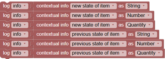

Moin,
openHAB 5.1.0.RC1
console.info((event.receivedState ?? event.newState));
console.info(event.oldState);
E: the same with
console.info(event.receivedCommand);
RC1 –> :+1:

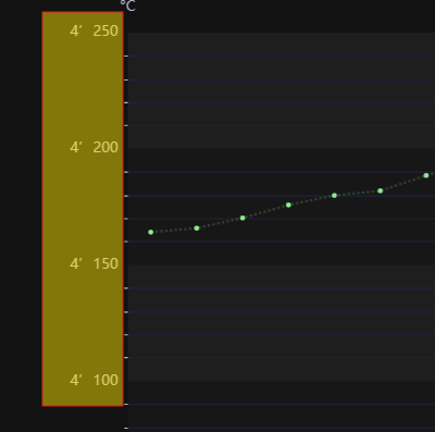

Only small feedback that looks not so nice:
These are 1000.
Not sure if it has to do with this change:
Charts: Add missing number format localization
A few days ago in snapshot I did not see that.
Or is there a setting for this in openhab / openhabian?
do you mean this is breaking event triggered blockly rules as the blocks are not translated correctly like e.g.
console.info(event.itemState?.toString());
console.info(((event.itemState !== undefined) ? parseFloat(event.itemState.toString()) : undefined));
console.info(((event.itemState !== undefined) ? Quantity(event.itemState.toString()) : undefined));
@florian-h05 : Is this maybe related to the issue you fixed in blockly
