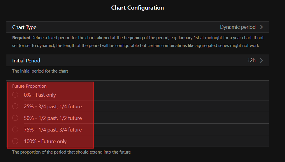

My Feedback for 5.1 M3:
  • It looks like there is a performance issue for charts with many items. E.g. I have a page with Grid 1 (50%) and Grid 2 (50%) with total 7 items and it takes 10s to show the graph.
  • Default Marker-Icons are not shown in map anymore. OH-Icon works
  • Upnp issues –> Sonos status doesn’t work (commands are OK). However, we have another thread for this.
    openHAB 5.1.0Mx: UPNP Issues - #47 by Lolodomo
BTW This is cool :slight_smile:
