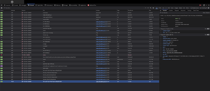

Since some days my mainUI is just showing a blank page.
http://192.168.1.30:8080 forwards to http://192.168.1.30:8080/overview/ but thats it. Tried chrome and Firefox, tried uninstalling habpanel and clear-cache.
Firefox shows the menu on the left, Crome nothing at all. In Firefox, I can navigate to the overview page, then it shows.
It did work a couple of days back but I have not the slightest clue what I did to break it. I am struggeling with persistence though but thats probably not connected. Any thoughts on how to debug this ?
The browser console and network tab might provide helpful information.

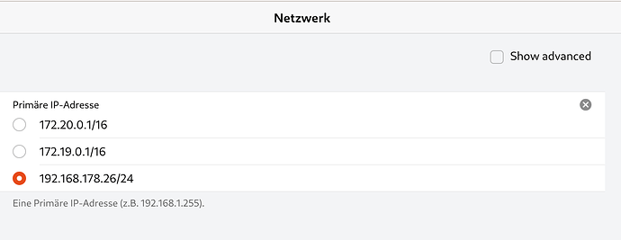

I set this in the UI
But still get this warning during startup
[INFO ] [.network.internal.utils.NetworkUtils] - CIDR prefix is smaller than /24 on interface with address 172.20.0.1/16, truncating to /24, some addresses might be lost bei openhab
this does not fit together…
The connection to http://192.168.1.30:8080/rest/events/states was interrupted while the page was loading. index-BKkrdbNu.js:23287:12
SSE error index-BKkrdbNu.js:23318:17
=!= Event source connection broken…
Primary IP doesn’t mean that openHAB will not listen on other IP addresses and won’t work with other IP networks. At least that is how I interpret the term primary IP and my openHAB is able to operate on multiple interfaces in different networks simultaenously.
@s0170071 Please use code fences, provide the network tab and your environment details.
Okay but why don’t get a waring about only one interface and not also the other one?
Because after your description I should see 2 warnings not only 1

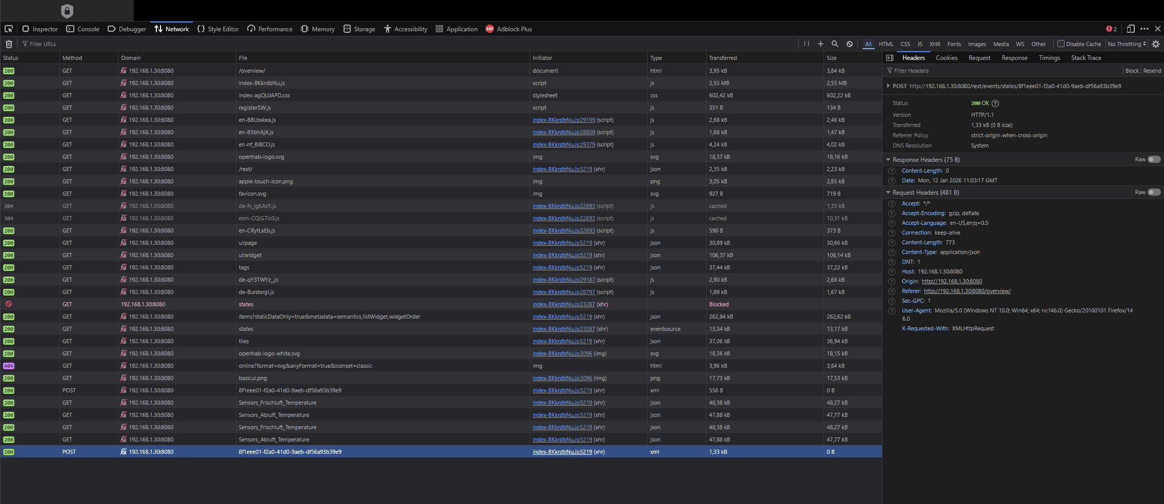

Havent found a reasobable way to copy that, hence the screenshot. Seems like a call to http://192.168.1.30:8080/rest/events/states does not get a reply.
But its not like its not working at all. If I click on the link of the page, it does load.

That is indeed interesting, I can’t answer that. I usually see several of those warnings when starting openHAB on my laptop (for development) as there are quite some virtual interfaces installed.
The network tab looks good, Main UI should display something. Again: please provide your environment details. openHAB 5.1.1 fixes an issue that makes the UI display nothing on some devices if the simple navbar is enabled.
Can i do any more troubleshooting or can I provide anymore info for this issue?
The widget YAML, but probably with hardcoded data values, so no items need to be configured.
Thank you ! That did the trick. I wasn’t aware there is 5.1.1 . Openhab website still advertises 5.1.0.
