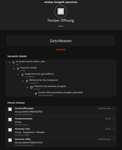

As I read the JSON, this Item is a member of the Equipment Group window_livingleft but it has no semantic tags at all.
    "semantics": {
      "value": "Point_Status_OpenState_WindowOpenState",
      "config": {
        "isPointOf": "window_livingleft" <--------------
      "editable": true
  "tags": [], <--------------------

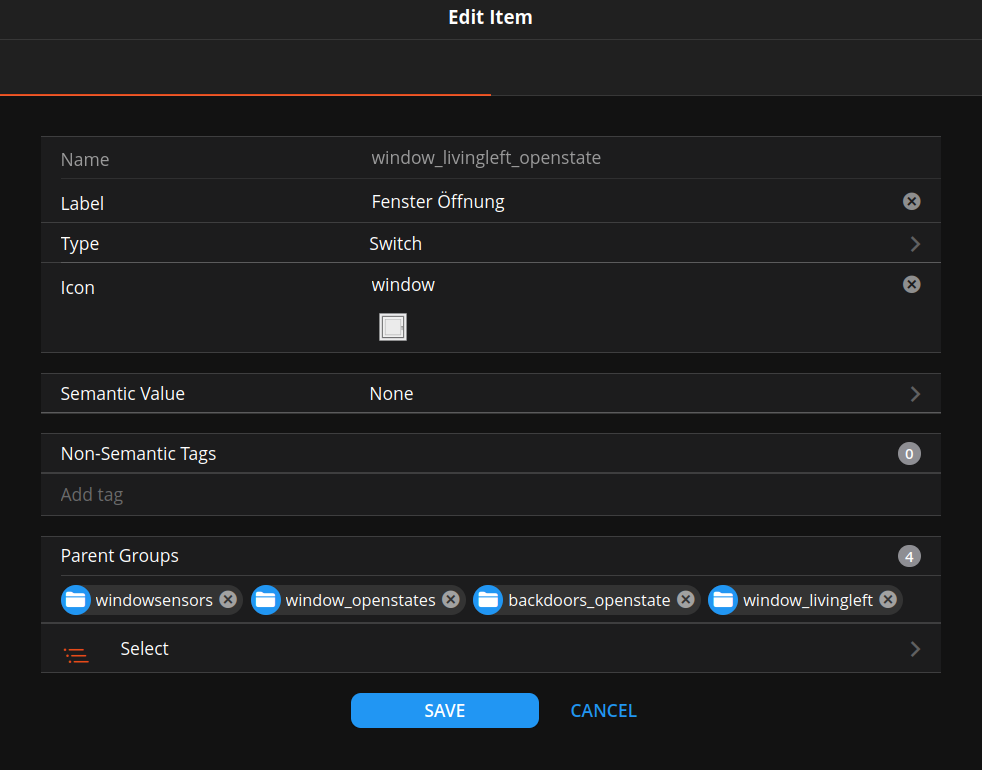

I hadn’t tried that before but just did it now after reading your post. However this also does not resolve the issue: the item is still shown in the semantic model under window_livingleft (yes this group still has an equipment tag) even when the item is no longer part of that group.

What does it show on the Item page (not the Item edit page). Does it show the Item in the semantic model? Does it show anything under metadata?
If you look at the model, where does it sit? Is it inside the semantic model? Switch on non-semantic Items. Can you drag and drop it out of the semantic model?
I am curious why it does what it does. If you create an issue, we probably may have to get hold of the json db to be able to reproduce it. So make a copy and keep it before you experiment too much.

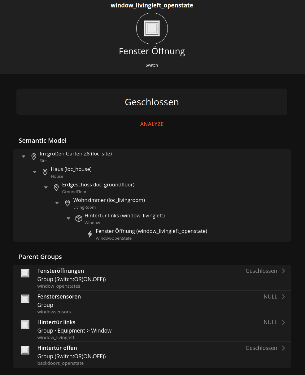

Item page (shown as part of the model):

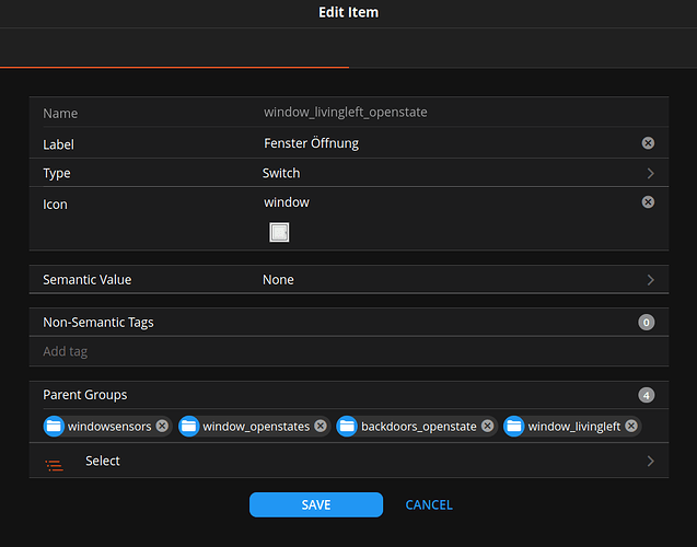

Item edit page (no semantic tags):

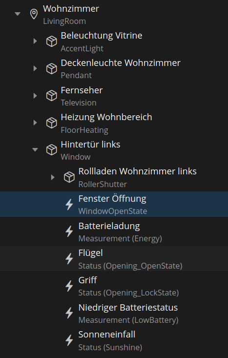

Model (It’s shown as part of the window equipment without switching on display of non-semantic items):

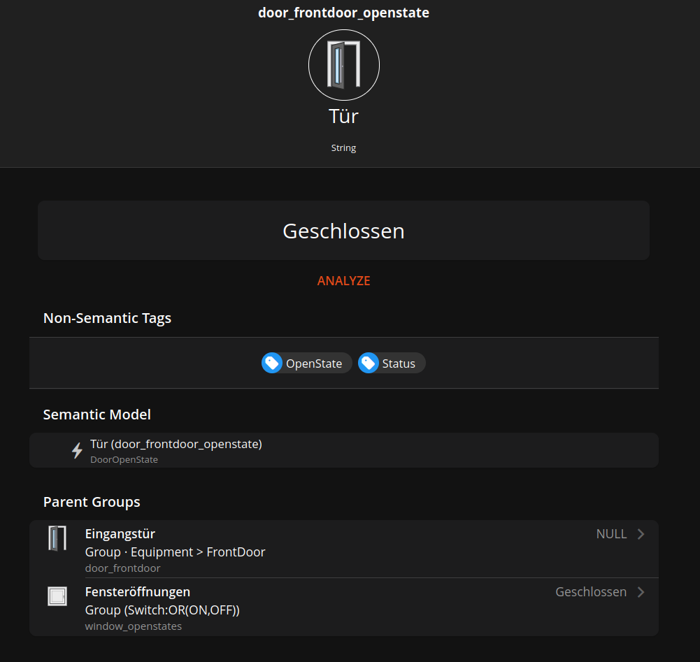

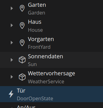

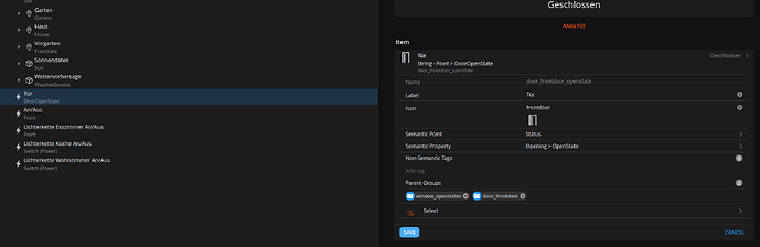

I got another item (front door open state) with the same problem but somewhat different symptoms. In the model view it is shown on the root level:
Same on the item page:

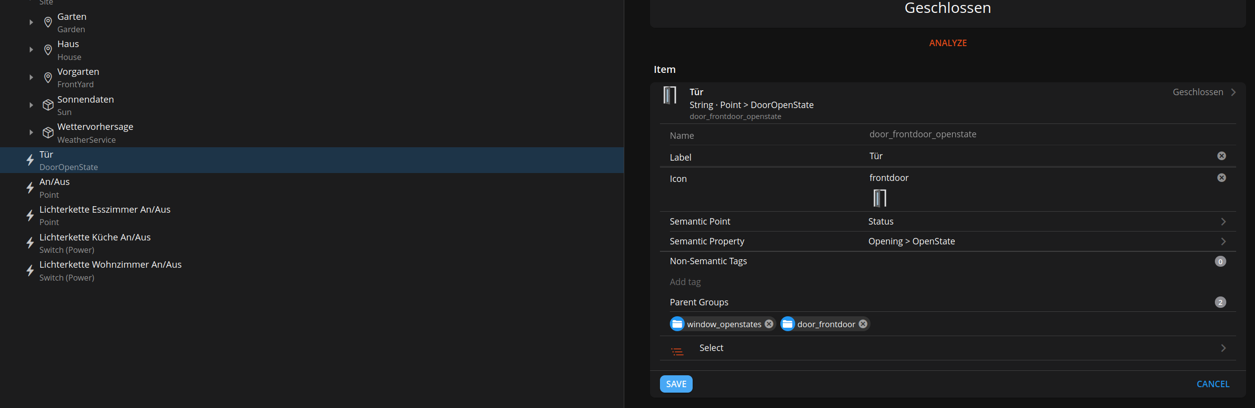

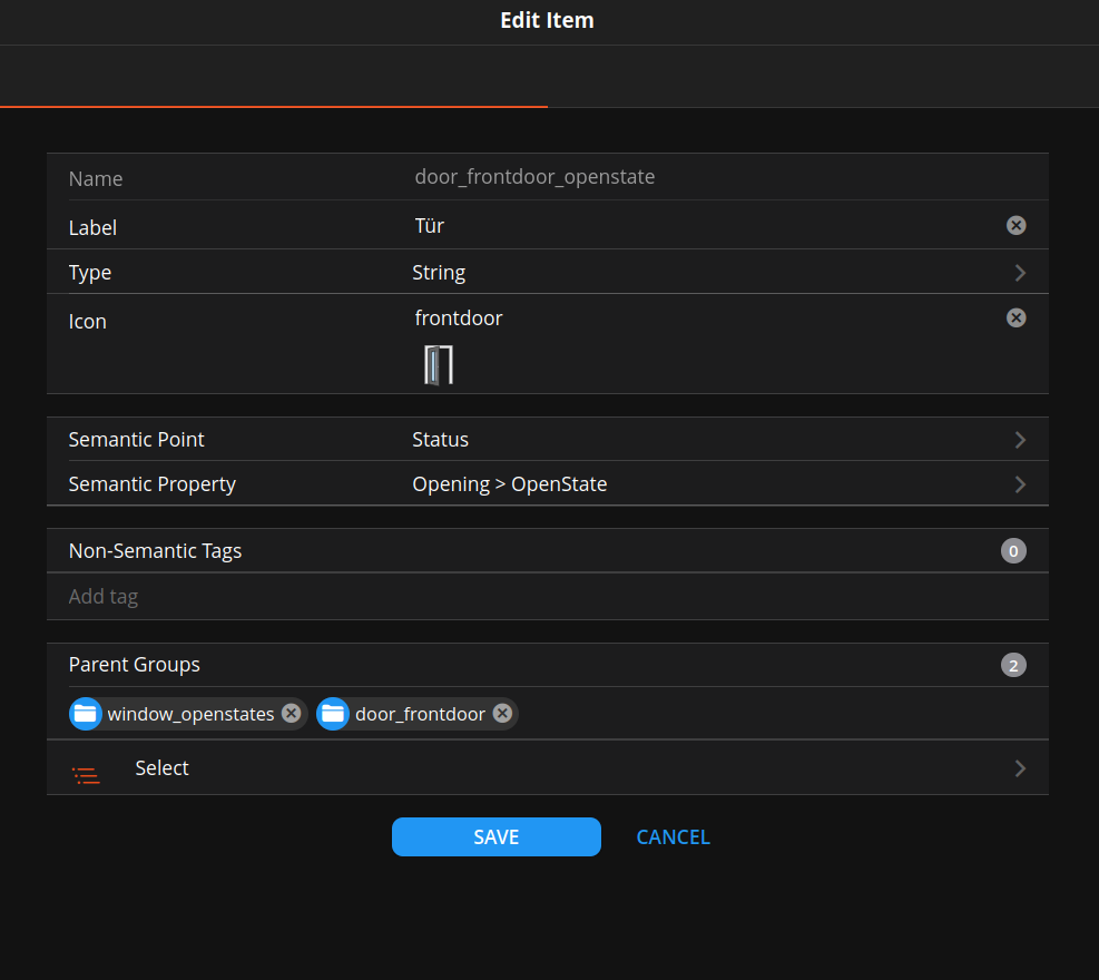

On the item edit page (seems to have the correct semantic tags):
API response shows the old no longer existing OpenState property:

Fun fact: When I open the item in the model view and hit save it moves to the correct parent equipment (door_frontdoor) but not permanently:
After hitting Save (looks correct but not for long):
