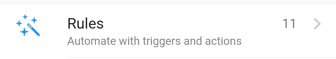

Unfortunately nothing changed on my side…still on 11 out of 64 rules are loaded…
M5build with 5.18.1 js lib
