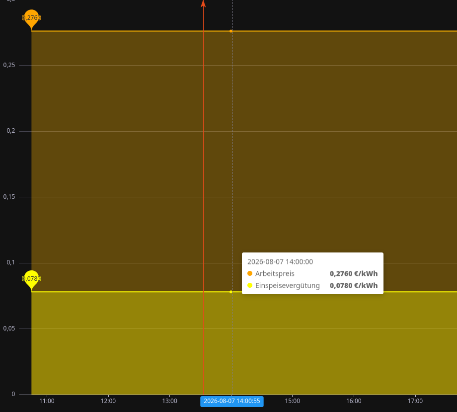

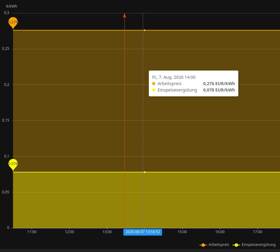

For me the maximum number of decimal places in an oh-time-series chart is not taken into account for values greater than 3. When setting the parameter to 4 only three digits are shown.
version: 1
pages:
  electricityForecastPricePerUnit:
    tags:
      - Preis
      - Strom
      - Vorhersge
    props:
      parameters: []
      parameterGroups: []
    component: oh-chart-page
      formatterMaxDecimalPlaces: 4
      future: 0.75
      label: Strompreis - Vorhersage
      period: 12h
      series:
        - component: oh-time-series
When using a custom formatter for labels and tooltips the fourth digits are always zero.
This appears to be the behavior that has always been in place. There used to be technical reasons see below why this was necessary but this behavior has been in place since OH 1.4 at least. I don’t know if that’s evidence for or against it being the intended behavior but there used to be enough problems with this behavior on RPi 2s back then (which were the minimum supported hardware) that people complained about it and tried all sorts of workarounds (no of which would apply to this specific problem). I imagine if it could easily be changed it would have been changed back then.
