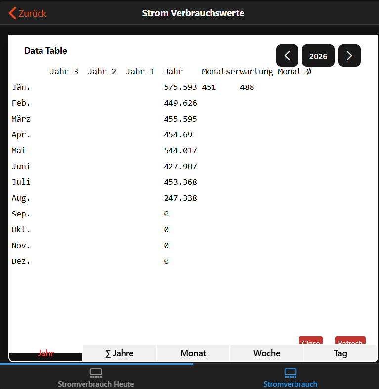

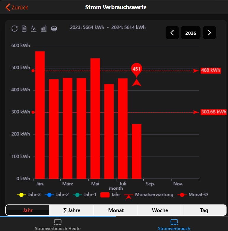

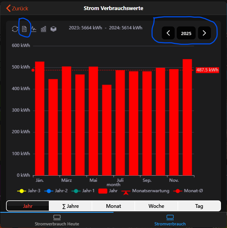

I run Openhab 5.2.1 and have a problem on the following page.
The month values of “Jahr-1” (green), Jahr-2 (blue) and Jahr-3 are no longer displayed. They should be displayed as “line” while the month values of the current year are displayed as “bar”.
The values of “Jahr-1”, “Jahr-2” and “Jahr-3” are also not displayed in the “data table” as it was in the older Openhab versions.
… even when I change the year (with button in top right) the values are displayed
The values are loaded by the following widget (line 592 - last “oh-chart” in the widget - “chartType: year”):
