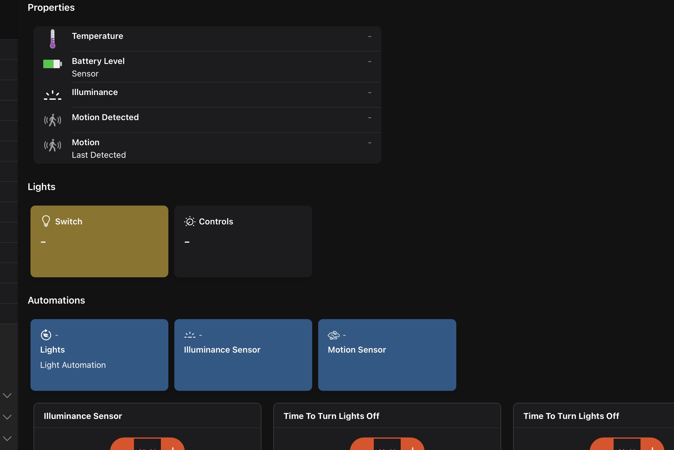

Apart from the previous topic, I’m experiencing sluggishness in the UIs (MainUI, iPhone App) with v5.2.1. Page elements load as fast as always. Only the item values take 5 to 12 seconds to load when I haven’t accessed a page for a while during the day.
Updating items also takes 5 seconds or sometimes more to be reflected on the UI. I.e., even though physical devices are instantly updated, item values don’t change instantly on the UIs as they used to before.
Before v5.2, both page elements as well as values were loaded almost at the same time, quite fast.
At home, my laptop, phone, OH server, and devices are connected to the same local network. When I’m away from home, I’m connected via Twingate to my home network. For the mobile app, it’s always a local connection (not myopenhab.org). In both cases, I face the same issue.
Is anyone else experiencing the same?
I think this might be [rest.core] Stop flushing the SSE stream manually by digitaldan · Pull Request #5863 · openhab/openhab-core · GitHub, which will ship with M2 soon. Once we’ve confirmed that issue is gone, we should backport this PR.
@digitaldan, @florian-h05, @wborn, you guys rock!
