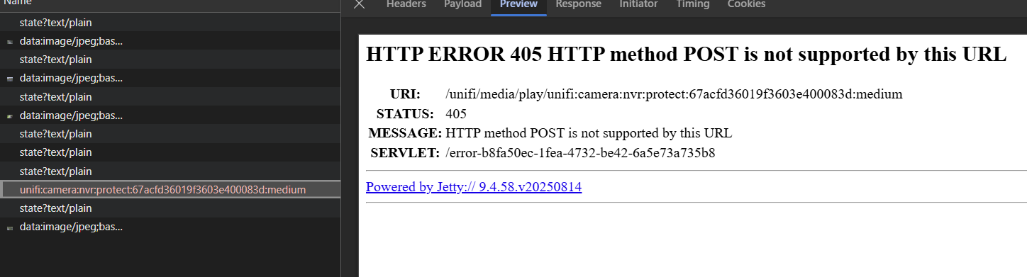

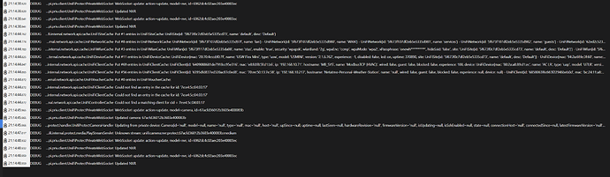

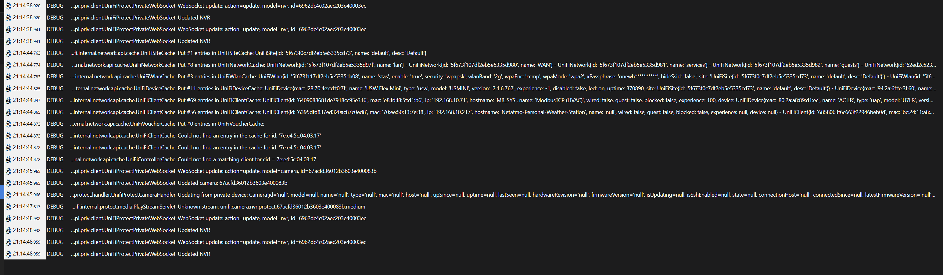

@stas-dovgodko can you put the binding in DEBUG mode and try streaming ? I’m curious if there something being printed there, i would expect a 404 vs 415 error is why i ask. Is there a proxy in front or something ?
Here is full unifi debug when I tried to open webrtc in oh-video
405 status, not 415 my fault
OK, thats a big difference and make more sense and confirms the fix i just put in, i’ll have something posted shortly.
Ok new unifi jar can be downloaded at
I would uninstall the old one first before dropping in the addons folder. And this says 5.3, but will work on a 5.2 system. Give this a try and let me know, i’ll open a PR up once confirmed.
