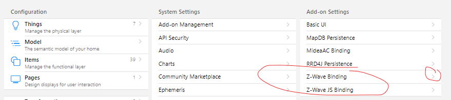

This is where to set log level on the OH5 UI

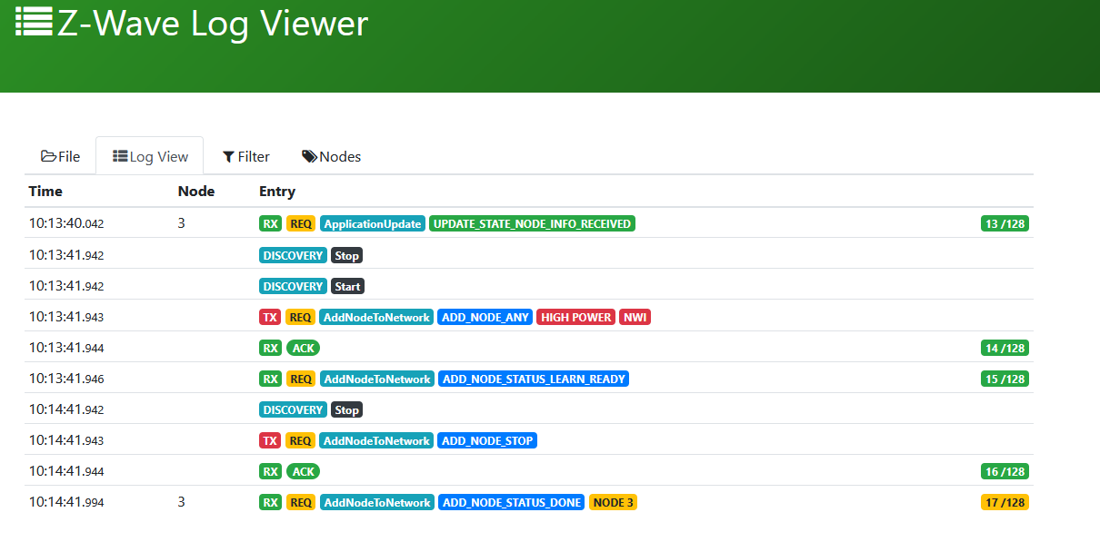

this is the code out of logviewer ( text and screenshot )
for me, i get no information abbout chanel out of the stick ( device fibaro smoker sensor are not found correct )
10:13:40.042	3
RX REQ ApplicationUpdate UPDATE_STATE_NODE_INFO_RECEIVED  13 /128
01 1C 00 49 84 03 16 04 07 01 5E 20 86 72 5A 59 85 73 84 80 71 56 70 31 8E 22 9C 98 7A F6
command classes:	ZWAVE_PLUS_INFO
	                BASIC
	                VERSION
	                MANUFACTURER_SPECIFIC
	                DEVICE_RESET_LOCALLY
	                ASSOCIATION_GROUP_INFO
	                COMMAND_CLASS_ASSOCIATION
	                POWERLEVEL
	                WAKE_UP
	                BATTERY
	                ALARM
	                CRC_16_ENCAP
	                CONFIGURATION
	                SENSOR_MULTILEVEL
	                MULTI_INSTANCE_ASSOCIATION
	                APPLICATION_STATUS
	                SENSOR_ALARM
	                SECURITY
	                FIRMWARE_UPDATE_MD
10:13:41.942
DISCOVERY Stop
10:13:41.942
DISCOVERY Start
10:13:41.943
TX REQ AddNodeToNetwork ADD_NODE_ANY HIGH POWER NWI
10:13:41.944
RX ACK 14 /128
10:13:41.946
RX REQ AddNodeToNetwork ADD_NODE_STATUS_LEARN_READY 15 /128
10:14:41.942
DISCOVERY Stop
10:14:41.943
TX REQ AddNodeToNetwork ADD_NODE_STOP
10:14:41.944
RX ACK 16 /128
10:14:41.994	3
RX REQ AddNodeToNetwork ADD_NODE_STATUS_DONE NODE 3  17 /128

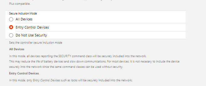

If you added with security before (which is still not clear to me), you will need to factory reset the smoke detector. In advanced on controller there is this;

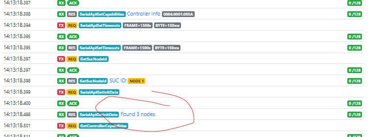

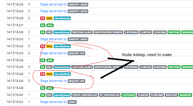

Zwave seems to start but never gets to interview the nodes. You need to wake them per the manual. If you no longer have that you can look at the entry on the ZW DB. Could be this one also.
EDIT: One further thing occurred to me. It was the devices that may need a factory reset, NOT the controller. Also the devices should be included while the stick in the OH server. Don’t use the button to include these devices.
If waking the devices doesn’t work (per suggestion above), exclude them using the Zstick button outside of OH. Yellow followed by green (If I recall correctly). Then put the stick back in the OH server. Scan in OH while pressing the device button to include.

What it looks like from the logs is that the smoke detectors are already on the Zstick when you start OH. How did they get there? The button is the zstick button.
EDIT: Need to press the button on the smoke detectors get past this;
If you get to this point, you don’t need to scan, just wake the device until it is configured. (Look for a node2 and node3 in the zwave folder.
