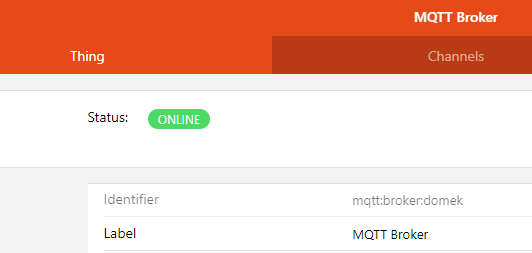

I’ve installed binding and added broker from UI:

Thanks, you were right - old approach. Change in rule helped:
val actions = getActions(“mqtt”,“mqtt:broker:domek”)
actions.publishMQTT(“test”,“test message”)
