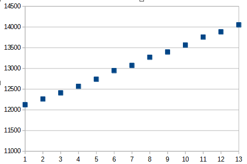

Commands seem to be quasi-equidistant:
A (PID) controller running havoc or a (malevolent) script? Since external lights are also affected at the same time, I wouldn’t rule out a hack.
