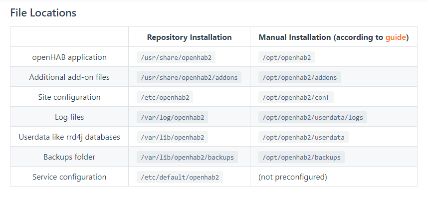

That depends on the installation method …
env | grep USERDATA
OPENHAB_USERDATA=/var/lib/openhab2
Thanks but i found the problem openhab user didnt have sufficient privileges on the folder
and they installed with apt. Oops. /opt is manual install. :frowning:
from openHAB on Linux | openHAB
