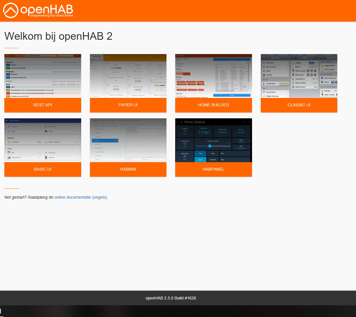

Hey,
I have a problem with my openhab2 installation. I noticed this yesterday because I had linked a Heos1 box to Openhab but I had taken the Heos1 box to a party on Sunday and placed it back home in the evening. I then noticed that I was no longer able to manage this with Openhab, while it was online in paperUI. So I thought I had to add it again in openhab but this didn’t work anymore. I had removed the bridge and player and had it searched again, but he doesn’t find anything, not even a bridge. After that I also tried to let the network bind search but this one didn’t works either, just like my niko home control binding, etc …
I have tried to remove and re-install the network binding, but this does not work either. It is removed, but it will not reinstall.
I did make a few changes to directories last week because everything was wrong with permissions.
See topic:
Could this have something to do with it? Can anyone help with this?

This is an excerpt from the openhab.log. I see the message failed to bind coming back every time. Could this have something to do with it?
![image|185x500](upload://cut8jW5iRKUId7Z0D8KCPZBedbQ.png) 2020-01-02 09:14:33.038 [INFO ] [.dashboard.internal.DashboardService] - Started Dashboard at http://192.168.0.29:8100
2020-01-02 09:14:33.041 [INFO ] [.dashboard.internal.DashboardService] - Started Dashboard at https://192.168.0.29:8101
2020-01-02 09:14:33.204 [ERROR] [.service.internal.HttpServiceStarted] - Could not start the servlet context for context path []
java.io.IOException: Failed to bind to /0.0.0.0:8101
