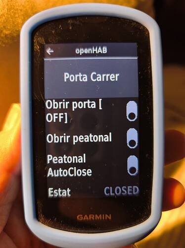

Would you mind showing how your sitemap configuration and item definition look for the element Obrir porta [OFF]? I’m still getting familiar with sitemaps, and so far I’ve only seen status values in brackets used with text elements.

This are the three items that I show as input:
Switch it_obrirporta "Puerta calle" <wallswitch> { alexa="ToggleController.toggleState" [category="DOOR", friendlyNames="@Setting.Opening", actionMappings="Close=OFF,Open=ON", stateMappings="Closed=OFF,Open=ON"], channel="mqtt:topic:domosquitto:carrer:obrirporta", expire="1s,command=OFF", ga="Switch" }
Switch it_obrirpeatonal "Puerta peatonal" <wallswitch> { alexa="ToggleController.toggleState" [category="DOOR", friendlyNames="@Setting.Opening", actionMappings="Close=OFF,Open=ON", stateMappings="Closed=OFF,Open=ON"], expire="7s,command=OFF", ga="Switch"  }
Switch it_peatonalautoclose "Peatonal Autoclose" <wallswitch> { expire="30s,command=OFF", ga="Switch" }

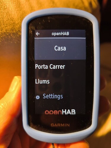

And this is my sitemap for garmin:
sitemap garmin label="Casa" {
	Frame label="Porta Carrer" icon="door" {
        Switch item=it_obrirporta label="Obrir porta"
        Switch item=it_obrirpeatonal label="Obrir peatonal"
        Switch item=it_peatonalautoclose label="Peatonal AutoClose"
		Text item=zigbeeportacarrer_estat label="Estat"
	Frame label="Llums" icon="light" {
        Switch item=it_lpergola label="Llum Pergola"
        Switch item=it_llumgaraix label="Llum Garaix"
As you can see, really doesn’t use anything special to show the [OFF], in fact I will prefer that doesn’t apeear, as I can see the switch.
I have done the thing using UI without text files for this binding.
I agree, I will remove it from the label:
