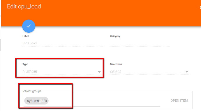

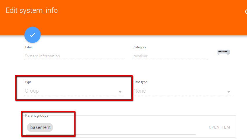

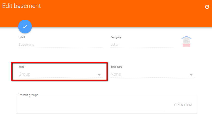

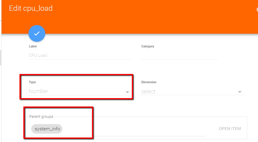

On OpenHAB a Group is a type of Item. You need to make a Group item before you can place items into the group. Here is an example from my setup. I will show 2 nested Groups and one linked Item

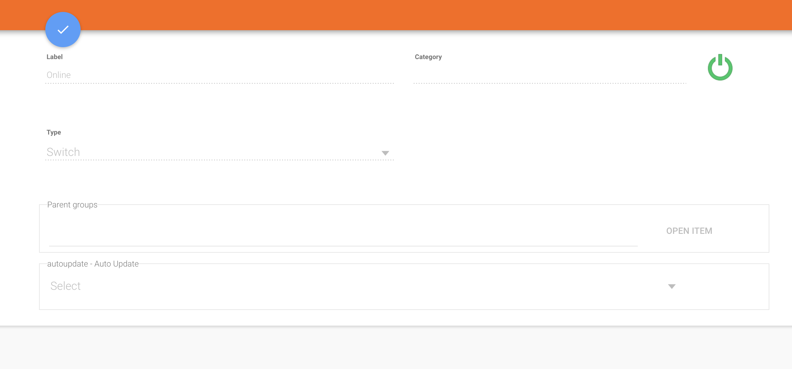

I cannot update the item. It does not allow me to update as it does not go into edit mode. I cannot enter/click in the Parent Groups fill-in/dropdown.
Please note that the things and items were created using simple mode.
