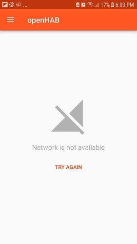

I have worked with openhabian for a while and was working fast but now it is very slow and show me some messages from time to time like
“Offline: waiting for connection to become available”
“Error:404 Not found”
Even when I open the android application show me this picture and does not work until I refresh it
Yes I updated openhab and cleared the cach from this location “\openHAB-share\openhab2-userdata\cache”
