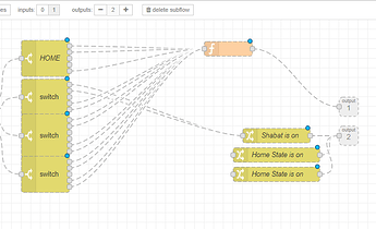

i start each flow, let’s say RF signals from PIR sensor will get msg.usr = PIR
so each msg object will have msg.usr = PIR starting from here

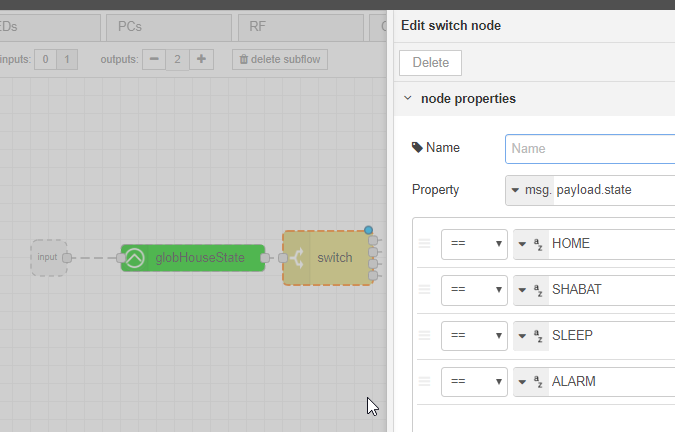

next, we go into the subflow Logic Gate
this Subflow will query OH for house State, so let’s say we are home
now we go into the home Switch, this will query msg.usr and will direct the msg
to the corect output
from there i use the two outputs for good and bad outputs…
so if i need the good and authorize output i use 1 … but some times you want to know whats going on , so to write error string on the 2 output
so we will know what went wrong
so now i can turn off rules, from this subflow and not go into the flows
i will just debug the flow that is giving me trouble and will remove that user, from that state, or add if need to
