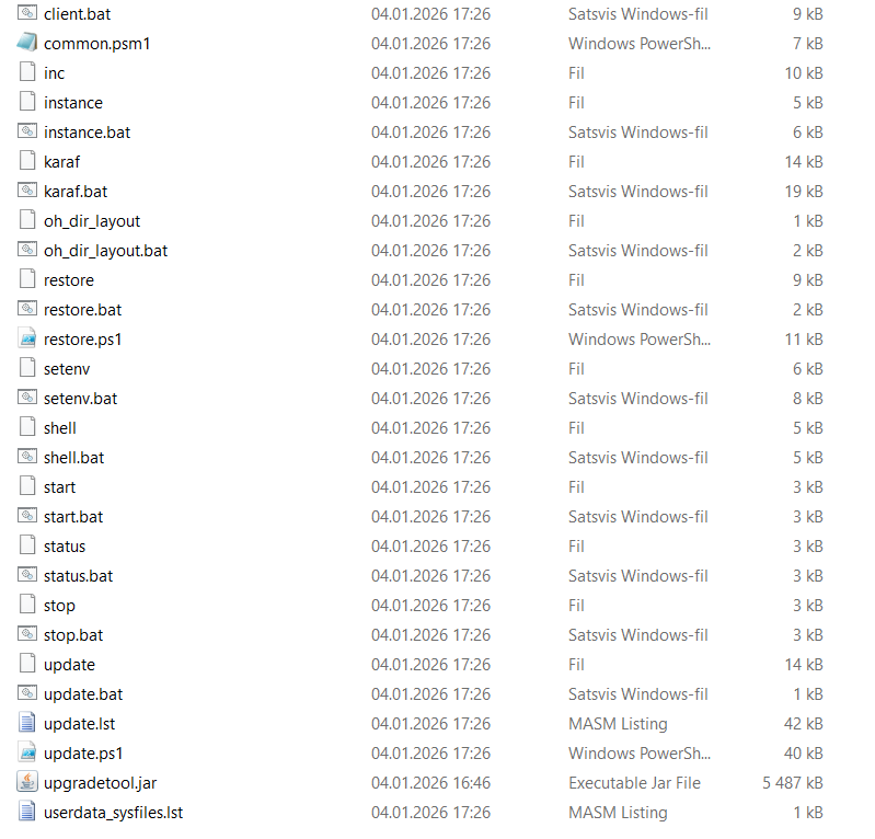

  • On manual installs, upgrading should be performed through the update script included in the distribution, which will handle the upgrade steps.

I think it depends on the distro. As far as I know, only Windows has such a script.

No. There are a lot of different files in runtime/bin after you unpack OH from an archive (if downloading manually):
update.bat just starts update.ps1 (which means that it won’t work from a “regular” Windows command-line aka cmd.exe). update.lst has what seems like both alert messages and some kind of list of files to be moved/deleted etc.(snippet):

Whether any, or all, of these files are packaged with package distributed installations I don’t know, but I would suspect so, as e.g. the backup script is also found there.
What I think is unique for the Windows script is that it actually downloads different OH versions. Why this is different for Windows and other platforms I don’t know.

edit: This is the content of /usr/share/openhab/runtime/bin on my openHABian production installation:
total 2.7M
drwxrwxr-x 2 openhab openhab 4.0K Dec 11  2024 ./
drwxrwxr-x 6 openhab openhab 4.0K Dec 11  2024 ../
-rwxr-xr-x 1 openhab openhab 7.4K Nov 24  2024 backup*
-rwxr-xr-x 1 openhab openhab 4.2K Nov 24  2024 client*
-rwxr-xr-x 1 openhab openhab 6.3K Nov 24  2024 common.psm1*
-rwxr-xr-x 1 openhab openhab 9.3K Nov 24  2024 inc*
-rwxr-xr-x 1 openhab openhab 4.2K Nov 24  2024 instance*
-rwxr-xr-x 1 openhab openhab  14K Nov 24  2024 karaf*
-rwxr-xr-x 1 openhab openhab  874 Nov 24  2024 oh_dir_layout*
-rwxr-xr-x 1 openhab openhab 7.9K Nov 24  2024 restore*
-rwxr-xr-x 1 openhab openhab 5.0K Nov 24  2024 setenv*
-rwxr-xr-x 1 openhab openhab 4.1K Nov 24  2024 shell*
-rwxr-xr-x 1 openhab openhab 2.8K Nov 24  2024 start*
-rwxr-xr-x 1 openhab openhab 2.6K Nov 24  2024 status*
-rwxr-xr-x 1 openhab openhab 2.6K Nov 24  2024 stop*
-rwxr-xr-x 1 openhab openhab  259 Nov 24  2024 update*
-rw-r--r-- 1 openhab openhab  33K Nov 24  2024 update.lst
-rw-r--r-- 1 openhab openhab 2.5M Nov 24  2024 upgradetool.jar
-rw-r--r-- 1 openhab openhab  933 Nov 24  2024 userdata_sysfiles.lst
So, the update file is very much there - I don’t know where the upgrade file is though - if it exists.
