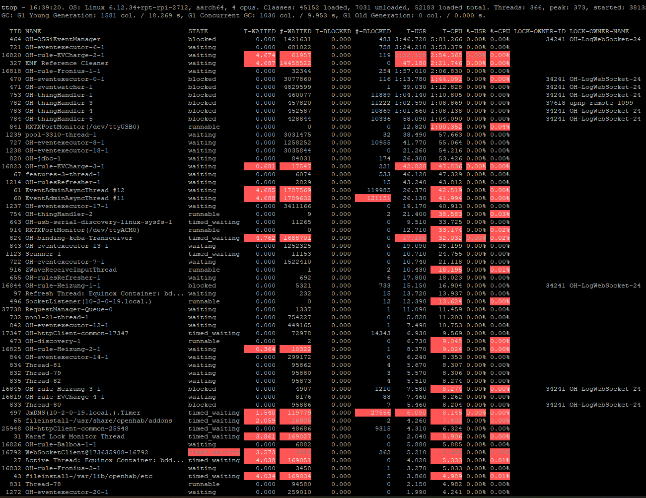

I tried out the hint - but I do not get anywhere with that.
ttop points to the thread OH-OSGiEventManager:
Thread 464 OH-OSGiEventManager BLOCKED

all threads are blocked by this one:

This does not help me to nail down to a rule or similar.
Anyone with an idea beside rebooting the system every few hours?
