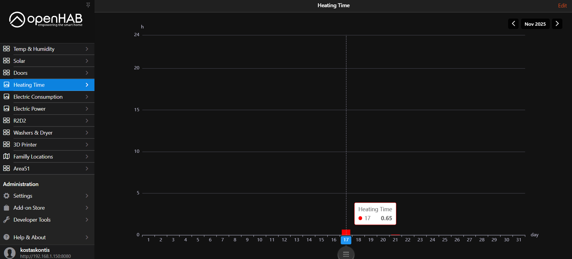

I also persist an item to see how much time my heating is on.The item is in minutes so i use a .js tranformation to make it readable and nice.So the item’s displayState is in form of 00h00m.My problem is that when i create a chart with days(bars) per month ,the item’s value is the unformated one….Is there a way to show the displayState value in the chart?

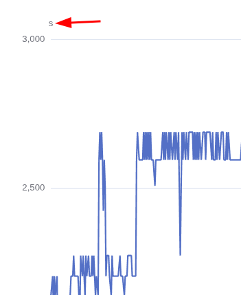

If you use a Number:Time Item you can use Date Time formattings without the transformation. For example my UPS runtime is a Number:Time Item with a state of 2250 s (I use seconds but you could set the unit metadata to minutes) and it displays as 00:37:00 using a state description pattern of %1$tH:%1$tM:%1$tS. That will work in a sitemap label too, just put the pattern in the [ ] in place of the usual %s.
When you use units, by default the unit of the Item will be included as part of the Y-axis label.
But it’s not used anywhere else. All the display state and unit stuff is implemented on the server side and for the most part is unavailable to the charting library.
my item is a plain number without unit and my trans script is this
(function(input) {
  if (!input) return "";
  const value = parseFloat(input);
  const hours = Math.floor(value);
  const minutes = Math.round((value - hours) * 60);
  // If less than 1 hour → show only minutes
  if (hours === 0) {
    return `${String(minutes).padStart(2, '0')}m`;
  // Otherwise show HHh MMm
  const h = String(hours).padStart(2, '0') + "h";
  const m = String(minutes).padStart(2, '0') + "m";
  return `${h} ${m}`;
})(input)
so i get a nice readble form everywher exept chart that shows the raw value.I think i might use somehow a proxy item to display the value nice in the chart…
My main point is that if you used units you’d at least get the unit displayed on the chart, and you wouldn’t need a SCRIPT transformation to see it displayed nicely.

I’ve tried your suggestion but still the raw value appears in the chart without unit.Everywhere else i use the item,widgets/sitemaps etc,it shows the formated value with unit…
The unit is there in the upper left. You have the unit set toh.
That is the only place it’s going to show up.
Charts are never going to show the formatted value. They are always going to show the raw numbers retrieved from persistence. All that charts can show is what unit those raw numbers from persistence are in.
