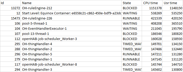

Ok I think I was able to do some digging now:
Here are my top threads sorted by cpu time
And shell:threads 13272 gives:
Thread 13272 OH-ruleEngine-212 RUNNABLE
Stacktrace:
org.eclipse.xtext.resource.SynchronizedXtextResourceSet.getResource line: 24
org.eclipse.xtext.resource.impl.ResourceSetBasedResourceDescriptions.getResourceDescription line: 111
org.eclipse.xtext.resource.impl.ResourceSetBasedResourceDescriptions$1$1.computeNext line: 74
org.eclipse.xtext.resource.impl.ResourceSetBasedResourceDescriptions$1$1.computeNext line: 64
com.google.common.collect.AbstractIterator.tryToComputeNext line: 141
com.google.common.collect.AbstractIterator.hasNext line: 136
com.google.common.collect.Iterators$5.computeNext line: 635
com.google.common.collect.TransformedIterator.hasNext line: 42
com.google.common.collect.Iterators$ConcatenatedIterator.getTopMetaIterator line: 1309
com.google.common.collect.Iterators$ConcatenatedIterator.hasNext line: 1325
org.eclipse.xtext.common.types.access.impl.IndexedJvmTypeAccess.getIndexedJvmType line: 109
org.eclipse.xtext.common.types.access.impl.IndexedJvmTypeAccess.getIndexedJvmType line: 101
org.eclipse.xtext.common.types.access.impl.AbstractRuntimeJvmTypeProvider.doTryFindInIndex line: 110
org.eclipse.xtext.common.types.access.impl.AbstractRuntimeJvmTypeProvider.doTryFindInIndex line: 95
org.eclipse.xtext.common.types.access.impl.AbstractRuntimeJvmTypeProvider$TypeInResourceSetAdapter.tryFindTypeInIndex line: 56
org.eclipse.xtext.common.types.access.impl.AbstractRuntimeJvmTypeProvider.tryFindTypeInIndex line: 120
org.eclipse.xtext.common.types.access.reflect.ReflectionTypeProvider.doFindTypeByName line: 128
org.eclipse.xtext.common.types.access.reflect.ReflectionTypeProvider.findTypeByName line: 109
org.eclipse.xtext.common.types.xtext.AbstractTypeScope.getSingleElement line: 59
org.eclipse.xtext.common.types.xtext.AbstractTypeScope.getSingleElement line: 54
org.eclipse.xtext.common.types.xtext.AbstractTypeScope.getElements line: 73
org.eclipse.xtext.scoping.impl.AbstractScope.getElements line: 137
org.eclipse.xtext.scoping.impl.ScopeBasedSelectable.getExportedObjects line: 40
org.eclipse.xtext.scoping.impl.ImportScope.getLocalElementsByName line: 154
org.eclipse.xtext.scoping.impl.ImportScope.getSingleLocalElementByName line: 142
org.eclipse.xtext.scoping.impl.AbstractScope.getSingleElement line: 105
org.eclipse.xtext.scoping.impl.AbstractScope.getSingleElement line: 108
org.eclipse.xtext.xbase.scoping.batch.TypeLiteralScope.getLocalElementsByName line: 48
org.eclipse.xtext.xbase.scoping.batch.AbstractSessionBasedScope.getElements line: 174
org.eclipse.xtext.xbase.scoping.batch.AbstractSessionBasedScope$1.get line: 180
org.eclipse.xtext.xbase.scoping.batch.AbstractSessionBasedScope$1.get line: 177
org.eclipse.xtext.scoping.impl.AbstractScope$ParentIterable.iterator line: 60
com.google.common.collect.FluentIterable$3$1.get line: 296
com.google.common.collect.FluentIterable$3$1.get line: 293
com.google.common.collect.AbstractIndexedListIterator.next line: 77
com.google.common.collect.Iterators$ConcatenatedIterator.hasNext line: 1330
com.google.common.collect.Iterators$ConcatenatedIterator.hasNext line: 1321
org.eclipse.xtext.xbase.typesystem.internal.AbstractTypeComputationState.getLinkingCandidates line: 412
org.eclipse.xtext.xbase.typesystem.computation.XbaseTypeComputer._computeTypes line: 1226
org.eclipse.xtext.xbase.typesystem.computation.XbaseTypeComputer.computeTypes line: 112
org.eclipse.smarthome.model.script.jvmmodel.ScriptTypeComputer.computeTypes line: 38
org.eclipse.xtext.xbase.typesystem.internal.AbstractTypeComputationState.doComputeTypes line: 121
org.eclipse.xtext.xbase.typesystem.internal.AbstractTypeComputationState.computeTypes line: 109
org.eclipse.xtext.xbase.typesystem.internal.AbstractTypeComputationState$1.getActualType line: 403
org.eclipse.xtext.xbase.scoping.batch.FeatureScopes.createFeatureCallScopeForReceiver line: 215
org.eclipse.xtext.xbase.scoping.batch.FeatureScopes.createFeatureCallScope line: 92
org.eclipse.xtext.xbase.scoping.batch.AbstractFeatureScopeSession.createFeatureCallScope line: 177
org.eclipse.xtext.xbase.scoping.batch.AbstractFeatureScopeSession.getScope line: 48
org.eclipse.xtext.xbase.typesystem.internal.ScopeProviderAccess.getCandidateDescriptions line: 142
org.eclipse.xtext.xbase.typesystem.internal.AbstractTypeComputationState.getLinkingCandidates line: 409
org.eclipse.xtext.xbase.typesystem.computation.XbaseTypeComputer._computeTypes line: 752
org.eclipse.xtext.xbase.typesystem.computation.XbaseTypeComputer.computeTypes line: 122
org.eclipse.xtext.xbase.typesystem.internal.AbstractLinkingCandidate.resolveArgumentType line: 627
org.eclipse.xtext.xbase.typesystem.internal.FeatureLinkingCandidate.resolveArgumentType line: 963
org.eclipse.xtext.xbase.typesystem.internal.AbstractLinkingCandidate.computeFixedArityArgumentType line: 579
org.eclipse.xtext.xbase.typesystem.internal.AbstractLinkingCandidate.computeArgumentType line: 443
org.eclipse.xtext.xbase.typesystem.internal.AbstractPendingLinkingCandidate.getConformanceFlags line: 999
org.eclipse.xtext.xbase.typesystem.internal.FeatureLinkingCandidate.getConformanceFlags line: 551
org.eclipse.xtext.xbase.typesystem.internal.AbstractPendingLinkingCandidate.compareByArgumentTypes line: 804
org.eclipse.xtext.xbase.typesystem.internal.FeatureLinkingCandidate.compareByArgumentTypes line: 613
org.eclipse.xtext.xbase.typesystem.internal.AbstractPendingLinkingCandidate.compareByArgumentTypes line: 679
org.eclipse.xtext.xbase.typesystem.internal.FeatureLinkingCandidate.compareByArgumentTypes line: 604
org.eclipse.xtext.xbase.typesystem.internal.AbstractPendingLinkingCandidate.compareTo line: 588
org.eclipse.xtext.xbase.typesystem.internal.FeatureLinkingCandidate.compareTo line: 742
org.eclipse.xtext.xbase.typesystem.internal.AbstractPendingLinkingCandidate.compareTo line: 523
org.eclipse.xtext.xbase.typesystem.internal.AbstractPendingLinkingCandidate.getPreferredCandidate line: 485
org.eclipse.xtext.xbase.typesystem.computation.XbaseTypeComputer.getBestCandidate line: 1238
org.eclipse.xtext.xbase.typesystem.computation.XbaseTypeComputer._computeTypes line: 1227
org.eclipse.xtext.xbase.typesystem.internal.AbstractLinkingCandidate.computeArgumentTypes line: 430
org.eclipse.xtext.xbase.typesystem.internal.AbstractLinkingCandidate.preApply line: 378
org.eclipse.xtext.xbase.typesystem.internal.FeatureLinkingCandidate.preApply line: 896
org.eclipse.xtext.xbase.typesystem.internal.AbstractLinkingCandidate.applyToComputationState line: 286
org.eclipse.xtext.xbase.typesystem.internal.AbstractTypeComputationState$5.applyToComputationState line: 511
org.eclipse.xtext.xbase.typesystem.computation.XbaseTypeComputer._computeTypes line: 1231
org.eclipse.xtext.xbase.typesystem.computation.XbaseTypeComputer._computeTypes line: 1222
org.eclipse.xtext.xbase.typesystem.computation.XbaseTypeComputer.computeTypes line: 110
org.eclipse.xtext.xbase.typesystem.internal.ExpressionTypeComputationState.doComputeTypes line: 59
org.eclipse.xtext.xbase.typesystem.computation.XbaseTypeComputer._computeTypes line: 495
org.eclipse.xtext.xbase.typesystem.computation.XbaseTypeComputer.computeTypes line: 118
org.eclipse.xtext.xbase.typesystem.computation.XbaseTypeComputer._computeTypes line: 259
org.eclipse.xtext.xbase.typesystem.computation.XbaseTypeComputer.computeTypes line: 132
org.eclipse.xtext.xbase.typesystem.computation.XbaseTypeComputer._computeTypes line: 483
org.eclipse.xtext.xbase.typesystem.internal.AbstractRootTypeComputationState.computeTypes line: 32
org.eclipse.xtext.xbase.typesystem.internal.LogicalContainerAwareReentrantTypeResolver._computeTypes line: 827
org.eclipse.xtext.xbase.typesystem.internal.LogicalContainerAwareReentrantTypeResolver.computeTypes line: 711
org.eclipse.xtext.xbase.typesystem.internal.LogicalContainerAwareReentrantTypeResolver.computeMemberTypes line: 897
org.eclipse.xtext.xbase.typesystem.internal.LogicalContainerAwareReentrantTypeResolver._computeTypes line: 886
org.eclipse.xtext.xbase.typesystem.internal.LogicalContainerAwareReentrantTypeResolver.computeTypes line: 705
org.eclipse.xtext.xbase.typesystem.internal.LogicalContainerAwareReentrantTypeResolver.computeTypes line: 697
org.eclipse.xtext.xbase.typesystem.internal.DefaultReentrantTypeResolver.resolve line: 164
org.eclipse.xtext.xbase.typesystem.internal.DefaultReentrantTypeResolver.reentrantResolve line: 139
org.eclipse.xtext.xbase.typesystem.internal.CachingBatchTypeResolver$LazyResolvedTypes.resolveTypes line: 80
org.eclipse.xtext.xbase.typesystem.internal.CachingBatchTypeResolver$2.process line: 57
org.eclipse.xtext.xbase.typesystem.internal.CachingBatchTypeResolver$2.process line: 53
org.eclipse.xtext.util.concurrent.IUnitOfWork$Void.exec line: 37
org.eclipse.xtext.util.OnChangeEvictingCache.execWithoutCacheClear line: 128
org.eclipse.xtext.xbase.typesystem.internal.CachingBatchTypeResolver.doResolveTypes line: 53
org.eclipse.xtext.xbase.typesystem.internal.AbstractBatchTypeResolver.resolveTypes line: 69
org.eclipse.xtext.xbase.typesystem.internal.AbstractBatchTypeResolver.resolveTypes line: 55
org.eclipse.xtext.xbase.interpreter.impl.XbaseInterpreter.internalEvaluate line: 216
org.eclipse.xtext.xbase.interpreter.impl.XbaseInterpreter._doEvaluate line: 857
org.eclipse.xtext.xbase.interpreter.impl.XbaseInterpreter.doEvaluate line: 231
org.eclipse.smarthome.model.script.interpreter.ScriptInterpreter.doEvaluate line: 226
org.eclipse.xtext.xbase.interpreter.impl.XbaseInterpreter.internalEvaluate line: 215
org.eclipse.xtext.xbase.interpreter.impl.XbaseInterpreter.evaluateArgumentExpressions line: 1205
org.eclipse.xtext.xbase.interpreter.impl.XbaseInterpreter._invokeFeature line: 1135
org.eclipse.xtext.xbase.interpreter.impl.XbaseInterpreter.invokeFeature line: 1081
org.eclipse.smarthome.model.script.interpreter.ScriptInterpreter.invokeFeature line: 151
org.eclipse.xtext.xbase.interpreter.impl.XbaseInterpreter._doEvaluate line: 861
org.eclipse.xtext.xbase.interpreter.impl.XbaseInterpreter._doEvaluate line: 458
org.eclipse.xtext.xbase.interpreter.impl.XbaseInterpreter.doEvaluate line: 239
org.eclipse.xtext.xbase.interpreter.impl.XbaseInterpreter.evaluate line: 201
org.eclipse.smarthome.model.script.runtime.internal.engine.ScriptImpl.execute line: 81
org.eclipse.smarthome.model.rule.runtime.internal.engine.RuleEngineImpl.lambda$2 line: 313
org.eclipse.smarthome.model.rule.runtime.internal.engine.RuleEngineImpl$$Lambda$529/14736831.run line: -1
java.util.concurrent.Executors$RunnableAdapter.call line: 511
java.util.concurrent.FutureTask.run line: 266
java.util.concurrent.ScheduledThreadPoolExecutor$ScheduledFutureTask.access$201 line: 180
java.util.concurrent.ScheduledThreadPoolExecutor$ScheduledFutureTask.run line: 293
java.util.concurrent.ThreadPoolExecutor.runWorker line: 1149
java.util.concurrent.ThreadPoolExecutor$Worker.run line: 624
java.lang.Thread.run line: 748

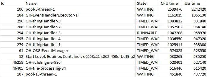

The system is for 8hrs now and goes in and out overload…
@mark_leonard_tuil could you check for threads? Maybe we’ll find some similarities…
Did a threads --list this morning and now it looks like this:
And a threads 106 gives:
Thread 106 pool-5-thread-1 WAITING
Stacktrace:
sun.misc.Unsafe.park line: -2
java.util.concurrent.locks.LockSupport.park line: 175
java.util.concurrent.locks.AbstractQueuedSynchronizer$ConditionObject.await line: 2039
java.util.concurrent.LinkedBlockingQueue.take line: 442
java.util.concurrent.ThreadPoolExecutor.getTask line: 1074
java.util.concurrent.ThreadPoolExecutor.runWorker line: 1134
