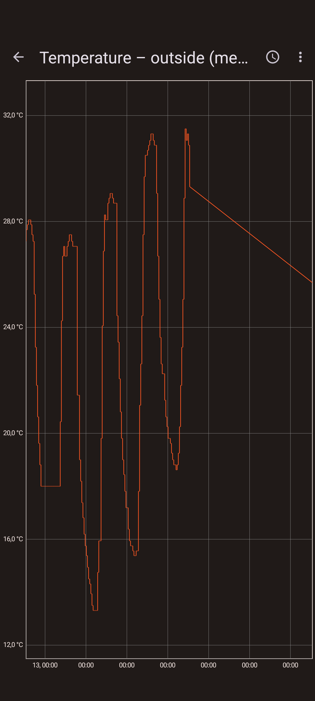

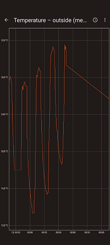

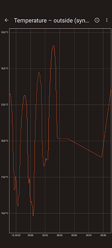

Since the update, item graphs seem to update far less frequently than they should (and used to). This is independently of the binding used.
For instance, this item uses the MQTT binding (with data provided by ebusd):
And this item uses the Open Meteo bridge:
