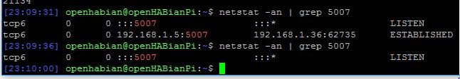

  • Server is listening to port 5007 and it seems it’s connecting with my desktop computer (see attached file)

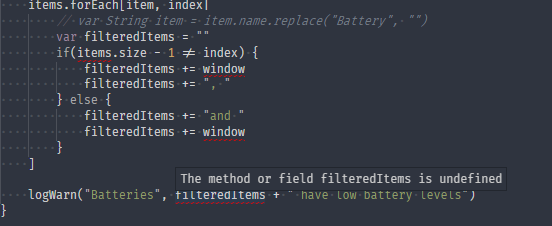

If it would work properly, would VS Code validate the code and mark errors/warnings along with a description of what’s wrong just like the Designer did?
Yes:
