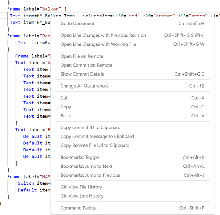

I am bit confused. I have tried to reproduce this problem but I don’t see these commands in my context menu for items or sitemap files. Also, I can’t see definitions for these commands in the extension definition file.
What exactly should this do anyway? If you’re right-clicking on the item in the items file or sitemap, aren’t you already looking at the item or sitemap definition?
BTW, there are some real issues with path mapping between the client where VS Code runs and the server where openHAB/LSP runs. I tried to fix one of them here, but there are still issues.
Yes, I tried it there. This is how the menu looks in my installation:
I have seen those two commands in editors for Typescript and Go but never in the openHAB editors.

any selection of the first 4 options cause the error
the first 2 options produce the error and close the file
the second 2 options leave the file open but produce the same error and no results
As far as I understand the extension’s code these 4 options should not be visible when editing .items or .sitemap files because there are no definitions for these options.

Uninstalled all, wiped clean all VSC related settings…
Installed clean again… can’t reproduce it (right click menu doesn’t show these first options anymore)
forget about it… i don’t know what the heck was wrong… I really had no customizations done to VSC in the past.
Only 2 extensions on top of OH (Debugger for Chrome and Powershell)
Now it’s getting interesting: I have created a fresh VSCode installation on a Ubuntu VM machine and now I can see this menu items (with version 0.4.0 …).
It seems that these options have to do with the LSP. If LSP is disabled the options are not visible but if I activate the LSP then these options will appear not immediately but some time later. It seems that VSCode activates these options automatically as soon as it gets a certain value back from the LSP server.
somehow the Linux path is visible to VSC and I can’t figure out how/where to change this…

ehm… with all settings clear I don’t see the menus under 0.4.1-b
the settings that I removed during the cleanup operation are:
    "openhab.username": "",
    "openhab.port": 8081,
    "openhab.password": "",
    "openhab.host": "homer",
    "openhab.lspEnabled": true,
    "openhab.useRestApi": true,
    "openhab.paperPath": "paperui",
    "openhab.restCompletions": true,
    "openhab.sitemapPreviewUI": "basicui"
I will try to put them back now
yup… confirmed.
with the minimum settings:
the bogus menu options re-appear.
Yes that’s it :-). But it only happens if the LSP really can parse the file. If it can’t get it because of the share definitions (see [LSP] Connection to LSP fails with internal error if smb network path is used · Issue #6611 · eclipse-archived/smarthome · GitHub) the menu options don’t appear (that’s why I was not able to reproduce it in my first tries).
We should disable these function if there is no working implemention. Will try to figure out whether we can do it in the extension or whether the LSP itself must do it.
you are correct.
Even on 0.4.0 these menu options appear
The difference in my 2 screenshots here is that the first one had no settings applied on settings.json
Since the default is: "openhab.lspEnabled": true
the setting that is affecting this is the "openhab.host": "homer" (without this, my local VSC on windows cannot connect to the remote Linux machine running OH2 and to the default LSP port)
