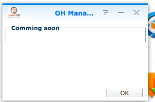

From the Dashboard I see that openHAB is running, I can stop it and uninstall it, but I have no access on the WEB interface.
