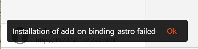

  • Issue of the topic: Unable to install add-ons.

This is a fresh install (i am using Sensors/IOTstack) . The part of docker-compose.yml with openhab is written above.
After the install, and configuring the user, when i try to add add-ons i get this error message:
This is my first attempt to use openhab with Docker. My former openHAB 2.5 install (RPi4/SSD) is using openHABian. That is running OK.
Hopefully someone has an idea where to look for this issue?

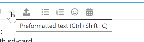

I am sorry, but i was using fence code:
But for some reason this did not worked as intenden.
But the code should be YAML formatted, and it is on my system; the docker-compose install install went without errors.
