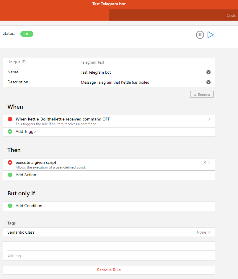

As I tried to implement a similar rule in OpenHAB3 I noticed that the rules assistant doesn’t provide access to the telegram action.
So just for my understanding. Is it correct that I now only have the option either to write a script function for this or I stay with the text bases DSL rules?

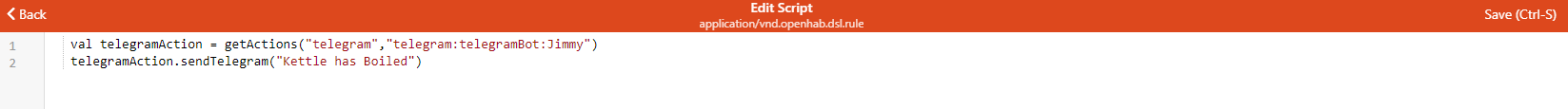

@denominator Thanks for pointing out. As said earlier I have already an OpenHAB 2 system with DSL scripts. Groups and triggering items are used a lot. It would have been nice to have at least these actions and triggering items available in these new, very much promoted, editors.
Your approach is for sure a solution, but adds a bit unecessary comlexity as I would have to maintain 2 scripts instead of one when sticking with rules DSL.
May be this will possible in the future and it would be very helpful for average user adoption, but currently it’s unfortunately (still?) not possible.
