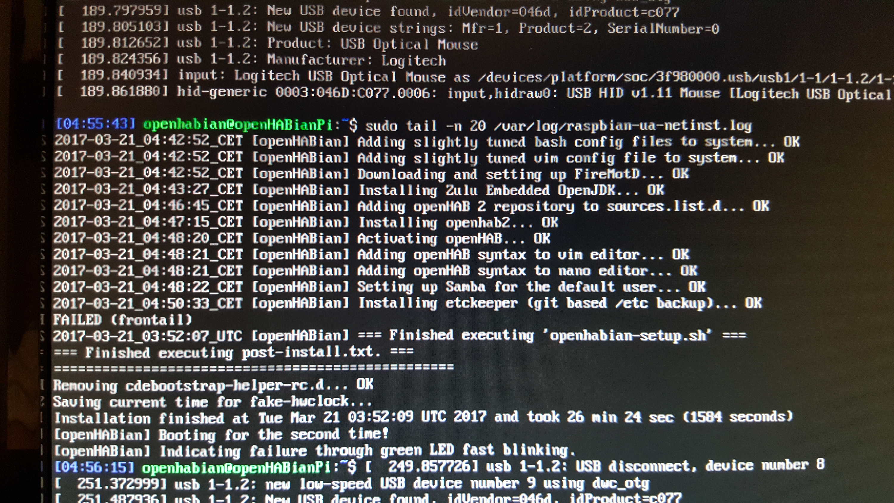

New to openHabian, and was super excited to see an “easy” option for us noobs. I have a Raspberry Pi 3 (RPi3) Model B Quad-Core 1.2 GHz 1 GB RAM, and a SanDisk Ultra 64GB microSDXC (SDSQUNC-064G-GN6MA) which has been formatted to Fat32. I’ve tried loading both the compressed image, and the net image, and both have failed multiple times. Here’s a screenshot of the most recent fail for the net version
Both packages (V1.2) seem to fail right after the etckeeper installs. I get a “FAILED (frontial)” message, and then fast blinks. Have tried multiple times, including wiping SD card, reformatting, unpacking, etc, but still am having no luck. From the looks of it, I might be one of the first Pi 3 folks. Would love any help that can be offered!

:astonished: Hey Sean, seems like this is a bug on my side. Adding frontail is a change from yesterday (I did not even write the announcement yet) and it seems to have caused a problem with the ua-netinst image (understandable, one of the reasons for switching to Raspbian). However this image will be discontinued. Could you please try the Rasbian image again. If you encounter an error there too (actually not expected) please post it here. I’ll do my own test run later this evening.

Thanks for the super fast response! Did the Raspian image change from last night? The file that was saved here: Releases · openhab/openhabian · GitHub (openhabianpi-raspbian-20170318-git9767b24-crc9616e8a1.img.xz) was the one I also tried originally before i attempted the net version. It had a similar problem and failed after etckeeper as well. The only additional piece of information that was provided in that log file was [openhabian] script ‘/boot/first-boot.sh’ failed. I didn’t capture a screen shot of this log, I just wrote down some chicken scratch, tried a few more times, then switched to the net version.
The only other errors I saw in the Rasbian image (which were sporadic during my multiple attempts) were a failure on “Installing basic can’t be wrong packages” and a “Failed to start resize2fs_once” service.

I’ve just removed frontail from the setup process. Please try the Raspbian image again.
I get the same error, but no output after (frontail)

FAILED (frontail)
This was installed from openhabianpi-raspbian-20170318-git9767b24-crc9616e8a1.img.gz on a Pi 3, with a 16GB card, no wifi enabled - wired connection.
Let me know if you need any logs etc. before I wipe the card and try something else.
Anthony
I’ve fixed that issue. Please try again. Sorry for the inconvenience.
