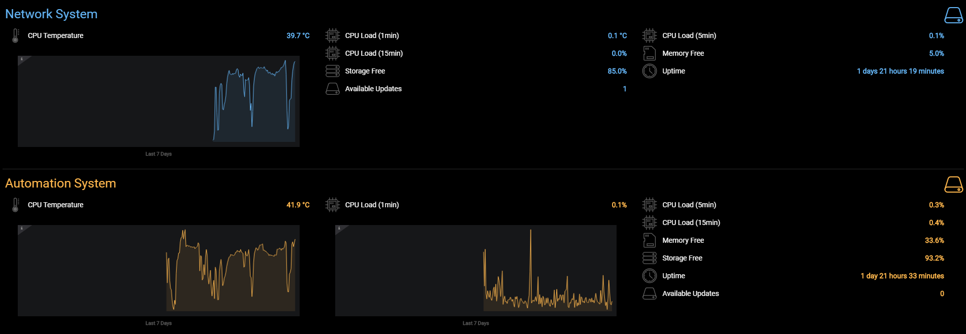

All graphs display at the same time, currently persisting every minute, this is probably too often than needed. The Raspi load is one if the graphs in question so yes, I’m logging this too. Load rarely goes over 0.5. Added screenshot of the openHAB widget I have configured, without the much wanted 4th graph, Network System CPU Load (1min).
